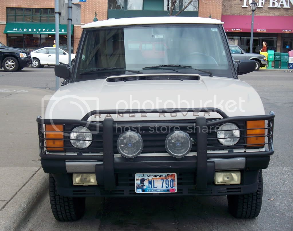

Ive been driving my 92 county for a while but other than a bad alternator it hasnt given me any trouble. Until last night. I was backing into a spot at the movies when I heard a very loud bang (like someone hit me). No impact tho just a noise. First thought was a broken driveshaft but the car goes forward and backward perfectly. This morning I got under there and had a good root around but other than my rear sway bushings being past it there was no evidence of any damage. The car is however kind of squidgy over bumps and has a very faint bumping sound coming from underneath. And heres the real wierd bit. When I bought the car I noticed that when turning into spaces the car would give me some resistance in the front. Kind of like the tires were rubbing (but they werent). Now when I drive into a space, there is no resistance at all. Anyone know what the hell is up? Pics for clicks. Its not mine but its pretty spot on.
