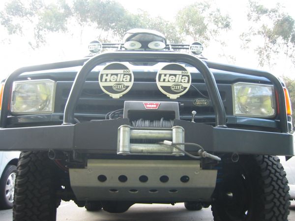

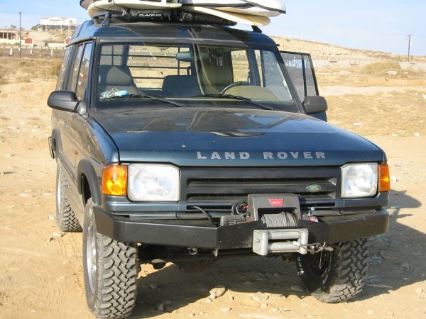

Don't get a hidden winch mount if you want to use it!
You don't have much access to the winch and can't see it spooling on a hidden winch mount. I like to see the cable spool and have access to the clutch when stuck in 2 feet of mud. You should bite the bullet and buy a good winch bumper first, get the BA175, $565. from DAP. It is light for an aftermarket bumper. You can add the brush bar from them as money becomes available. If you already have a winch great the tray will fit most 8000 & 9000’s. I know that it will work with your skid plate. I like the set up because if you bend your brush bar just get a new one, they're modular. The brush and bumper set up is lighter than TJM and ARB, so if there are kangaroos or deer on the roads near you, maybe this is not a good choice. The bumper won’t move boulders and large trees for you, but that is what ****** blocks and winches are for, in the first place!
