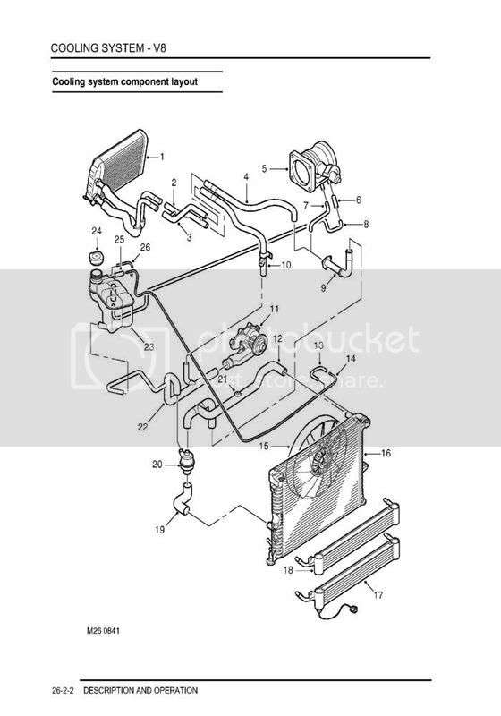

Looks like the deal I got on my new Disco is being overshadowed by my ever increasing list of must fixes. Let me preface this by saying I am new to LR’s and while I am by no means a professional mechanic, I can usually do my own repairs. My 2003 Discovery sprung a leak in the coolant system, where one line from the coolant reservoir and the other from the thermostat(??) meet with the air tube from the air cleaner just under where the throttle cables connect. It’s not leaking from the lines themselves or at the clamps, I don’t know what it is called but it’s where there is a seam under the throttle body. Has anyone experienced this problem before and if so, is it a simple repair? It looks fairly simple but I do not have a repair manual yet and I don’t want to start removing sensors or anything else until I know what they are. Here is a dumb? Should I just take it to the shop. Cannot afford to take it in for every little repair. Thanks

this is what mine looks mad

Thanks, Disco Mike steered me towards the Throttle Body Heater (between #5 and #6 )and suggested that I bypass by connecting #6 & #7.

This should have been fixed under warranty by the dealer. See published service action below:
SERVICE ACTION
Throttle Body Heater Gasket Replacement
AFFECTED VEHICLE RANGE:
DISCOVERY SERIES II (LT) XA200412 to XA208015
XA900000 to XA904569
SITUATION:
DURABILITY IMPROVEMENTS TO THROTTLE BODY HEATER GASKET
A change in material used for the throttle body heater gasket improves the service life of the component.
RESOLUTION:
REPLACE GASKET WITH NEW SPECIFICATION GASKET
Under this Service Action the new-specification throttle body heater gasket will be installed to improve the reliability of the vehicles within the specified VIN range.
