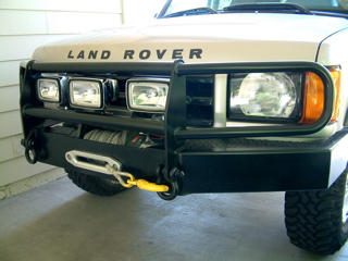

Front light assembly
I heard that Sergei,
I can help if it were a headlight problem, but not the lower lights. I broke my bumper so bad and sooooo often that I made a switch to some armor plating.
Mike J.

Figured it out
It looks like there are two "guide posts" and one threaded fastener. So I just have to remove the screw again and then use brute force, leverage and awkwardness and it should be a done deal!
