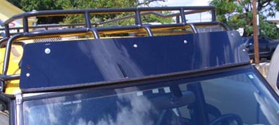

For those of you who have the full size roof rack for your D1 or D2 and cannot stand the noise, I have THE solution! It's easy and cost effective and reduced my wind noise on the highway by at least 90%! It is wonderful to be able to carry on a conversation with a passenger without having to scream. Here is the oh so brief low-down. I went to my local bicycle shop and purchased a Yakima wind fairing FOR A VAN (approx. $70 US). The others are too small and won't work. From there, it was most simple to install the rack into the brackets that are already there for you. That's right, just use the 4 light brackets and they make for beautiful mounts! There is some MINOR engineering involved and I am happy to send detailed photos to anyone intertested. Just e-mail me.

Could you post some pics of your wind fairing mounted on the rack?

Tried that route. No worky. They wanted almost $80 for a custom piece of black PVC plastic then I would have to go out and spend more $$ on trim for the edge touching the roof as well as all the required hardware to mount. I got everything I needed and had the job done in less than 1 hour. Don't know about you, but I would have spent 6 hours chasing parts down and running around town. I make more than the $6.60/hr. I would have saved by parts hunting.
