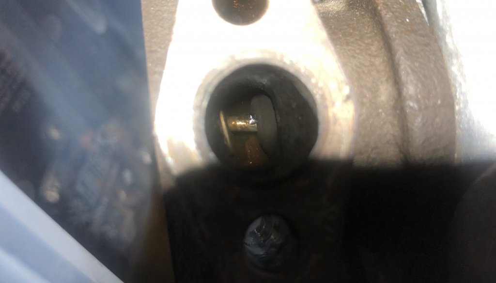

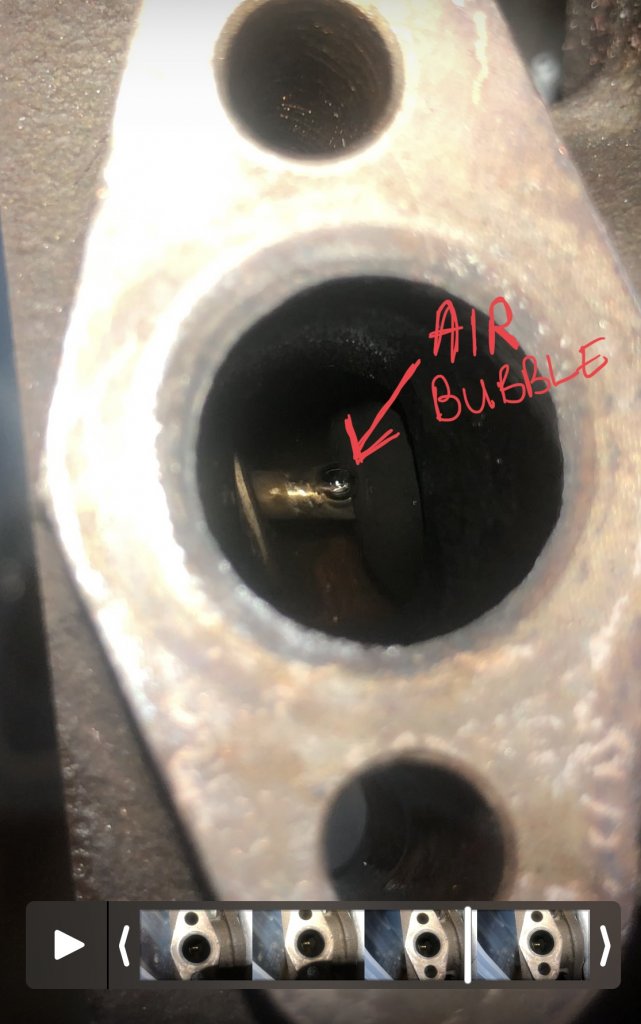

Engine runs great and sounds like a sewing machine aside from the perturbations and I began to suspect the EGR valve, but didn’t want to drop $400 without being somewhat sure. Pulled it off this morning with the intention of cleaning out the carbon and inspecting the pintle seat. Didn’t look too bad and the pintle seat looked fine. What I did notice when I filled the internal chamber with carb cleaner was an air bubble coming from the actuator shaft. I’m pretty sure the EGR valve is working, but the actuator seal/bush is worn and creating a vacuum leak into the inlet manifold when the valve is closed at idle. Not sure how it’s designed internally, but I did notice quite a bit of side play in the actuator shaft.

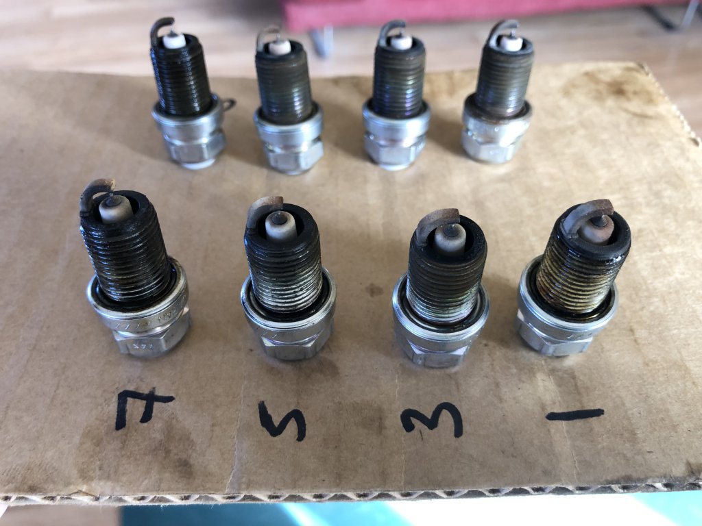

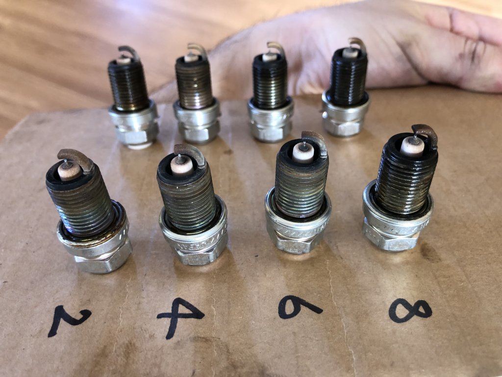

I replaced the EGR valve last Wednesday and it did nothing to fix the lumpy idle issue, although the old valve had tons of play in the shaft compared to the new. The problem actually got much worse on Friday, to the point I was worried about making it home from work and so the only thing left was either ignition coils or spark plugs. I decided to pull all plugs this morning, which is what I should have done in the first place. Ignition coils superficially all looked ok and again, I never had any misfire codes.
When I went to undo #5 spark plug however, it was essentially slack and took no effort to unscrew! The others were all tight. The crush washer on #5 plug was also dirty compared to the rest, indicating it hadn't been sealing to the head properly. I was sort of expecting the plug electrodes to look worse than they did, but they all look fine for the 25k they have on them. I fitted them 5 years ago and I've never experienced a plug come loose before.
I cleaned and put everything back together and from a cold start the problem was completely gone. Rock solid idle and no exhaust pops. Took it for a spin around the block to warm it up, drove great, but the problem now only manifested itself when the engine was hot and still 95% better than it was before. I suspect the crush washers on the spark plugs aren't sealing 100% when things expand and I'll have to fit new ones.
I guess the lesson here is to not overlook the basics!
(Edited: Cylinder numbering is wrong in the photos. Cylinders #1 and #5 are at the front of the engine. #1 is left bank viewed from FRONT of engine)
Plugs that look wet is just WD40 I used to lubricate threads when removing. #5 crush washer dirty.
