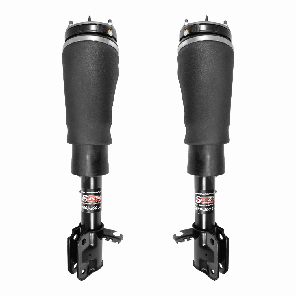

Finally traced () the suspension problem on our 2006 L322 to the front left airbag. There is a crashed RR Sport locally with undamaged air bags. Are they interchangeable by any ****** of luck. Otherwise I’ll need to get some shipped in which takes time and a lot more pricey (we’re in Barbados). Suspect they’re not but thought it worth asking the experts first.

L322 won't fit. Completely different. L322 shown below.
