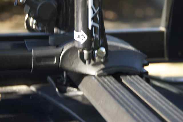

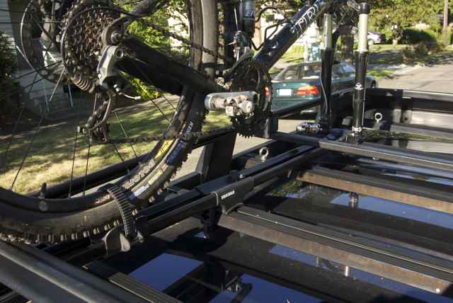

Attached is a couple of pictures. Let me know if you need more.
A couple of comments. The first suggestion is that if you are mounting the fork-front facing forward, you will need to mount on the second crossbar as it will interfere with the sunroof opening. I have an XL sized mountain bike so the rear tire hits the upper cross rail. It's tight but it works. You may have the same type of problem with a road bike or casual/commuter bike. One solution would be turn the whole assembly around and mount it backwards. I will probably do that for a second bike. One other suggestion would be to mount the bike rack on the passenger side (I haven't done that yet) so that you can use the curb as extra height to get the bike up and down.
You will notice that I'm using and extra Thule bar to mount the front tire carrier also.
The whole thing is very solid and stable, just working on perfecting it a little at this point.
Cheers
Andy
