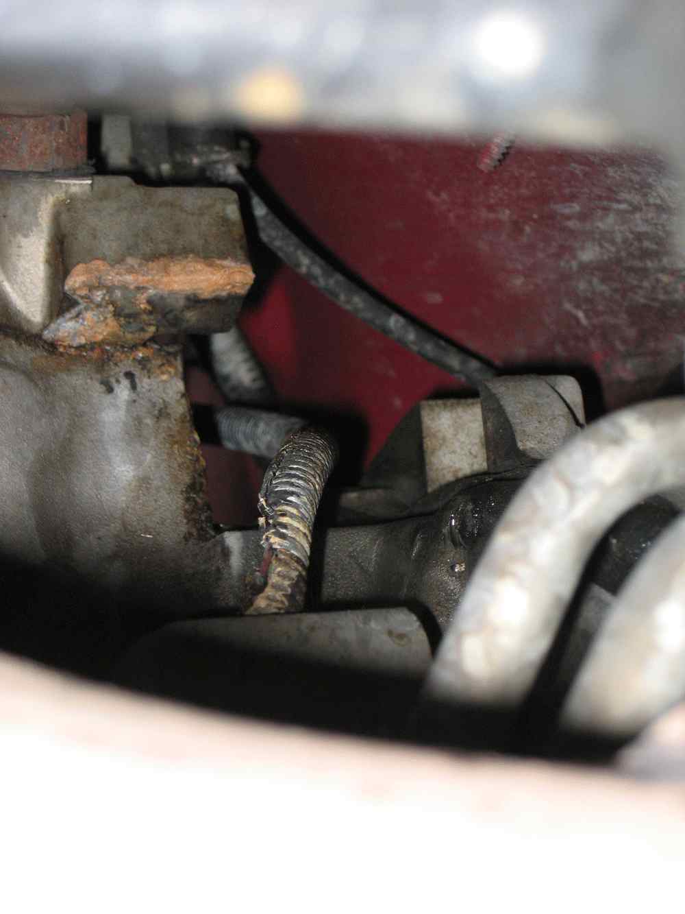

Found a MAJOR leak (50% of the fluid gone in 50 seconds)
It looks like it's coming from this busted line.. But I'm not 100% sure - Can someone confirm this is a Coolant line? And that all my cooland is coming from here?

FYI, this is on the drivers side of the engine, going into the engine. Also, some of the cheap plastic screw they gave me (Which the cap popped off. I received my brass one from EE today ;) ) fell into the radaitor. How worried do i need to be about that?

Rich, How many miles again? I cant tell from that picture. Its too large..Can you make it smaller please ? You said Bank A of the engine ..Where exactly on the engine.....? That wire looks corroded like it has come in contact with battery acid maybe?
