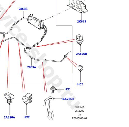

I replaced my rear wheel bearing this weekend which lead me to replace the rear parking brake pads and hardware. In removing the right (passenger) side hub assembly I broke the cir-clip (HC-1 below) on the parking brake cable as it enters the back plate. This clip is under the plastic screw on cover / cap with a knurled OD and a hex. On the drivers side I realized I did not have to remove the clip to get the cable out of the backing plate, so I didn't break it. The problem came during reassembly.

I bought the clip today from a local LR dealer so I'll be able to put the clip on tonight.
I guess I am preemptively trying to get some ideas in case the clip does not solve the issue. I find it hard to believe that the cable being into the backing plate a little further because the clip is not present would cause this kind of an issue.
