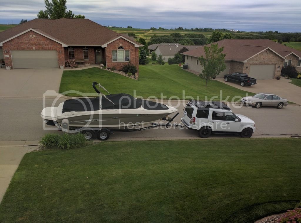

Do a search here, you should find some good threads about towing and different setups. I think the LR4 is a great tow rig. I use the factory tow setup and I think it is fine for my 24ft boat which weighs about what you are looking to tow. You will read about some other options and opinions which people think they need, but I haven't found or heard anything convincing that proves to me that it is needed.
We tow our heavy SeaRay all over the place and locally for boating on the mississippi river.

We tow locally probably a dozen times a year plus a big trip to a lake which is 3+ hours each way. When we bought the boat we towed it about 5 hours to get it home.
Only thing I don't like is the width of the mirrors is a bit small for a 8'5" wide boat.. and mirror extensions kinda suck. They vibrate like mad, so I don't use them.

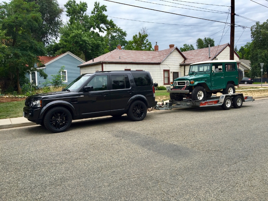

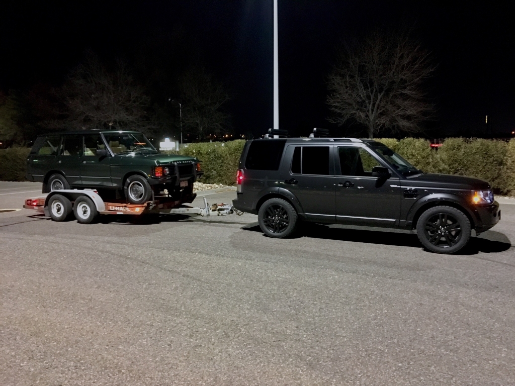

I tow 5500 & 6700 lbs at high elevation (up to 11000 feet) during the summers, and my '13 LR4 does very well. Hopefully I'll get to knock that load down ~800 lbs once I buy my own trailer. The quick-release hitch's max tongue weight of 770 lbs is sufficient for me.
Also, Tahoes are great tow rigs and can take a massive beating. That may be the better long-term tow rig, but as an all-rounder, it falls short of the LR4's versatility, capability, and refinement in my opinion.
