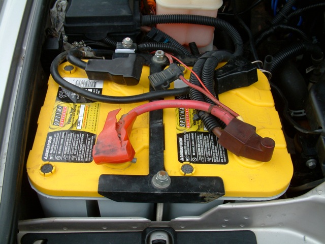

Well, as you can see, I run Yellow Tops and have for sometime. That being said, you must run matched batteries when running dual and if I had to do it over, I might switch to the Sears battery based on it's manufacturer and output.
What will you be using your's for?
thanks for the replies. what do you mean by matched batteries? my main cranking battery is an interstate mega-tron plus. the main use of the 2nd battery will be to run an ARB fridge full time. the two new 12 volt sockets in the rear will be used for fans/lights/inverter when camping.
