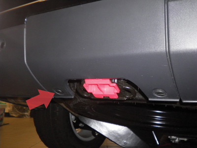

All LR4's come with the hitch mount. After reading the options on the website it sounds like if you paid for the Tow Package @ $650 you should get the accessory you listed above. The quick release goes into this spot:
Once you have the accessory above you then get your hitch with a ball and insert it into the accessory.
You should never leave either of these items permanently on your vehicle.

As epiclr4 said, the hitch receiver actually slips up into a slot where you see the red "filler". (That simply pulls out and you can put it away.) You then slide the hitch receiver accessory (mine is green colored) up into the slot and it locks in place. It can be removed (though the technique for doing so took me a while to figure out so you'll want the instructions) and can only be unlocked with one of the provided keys. My hitch receiver is typically on my LR4 during cycling season so I can easily throw my bike rack on but comes off if I head off road. And it stays off over the winter though I leave it in the back of the truck for whatever - with the key. It is actually very handy that it can be easily removed. As said, you don't want to be going off road with it.
