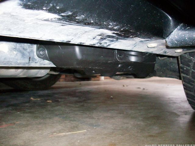

Re 1. above, in theory yes. Attached is a picture showing the cover of the newer AMK compressor that replaced the original Hitachi. The new case was deeper than the original and hence clearance was reduced a bit but primarily it is a slightly different shape than the Hitachi case. My thinking is that the AMK compressor is not that much better than the original Hitachi, hence if I needed a new compressor, I would still go with the Hitachi; also I would not have to do the software update the AMK requires.

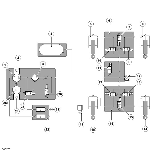

It sounds as if you have a pretty good knowledge of the air system if you were able to rebuild the front air block. You might find the files within the link below of some value however. There is much more than air system stuff within the files and some of the material has over five thousand views.
AMK compressor cover bottom half mounted.jpgLR3 Air Suspension Schematic Block diagram.jpg
