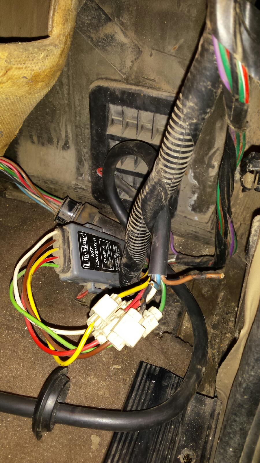

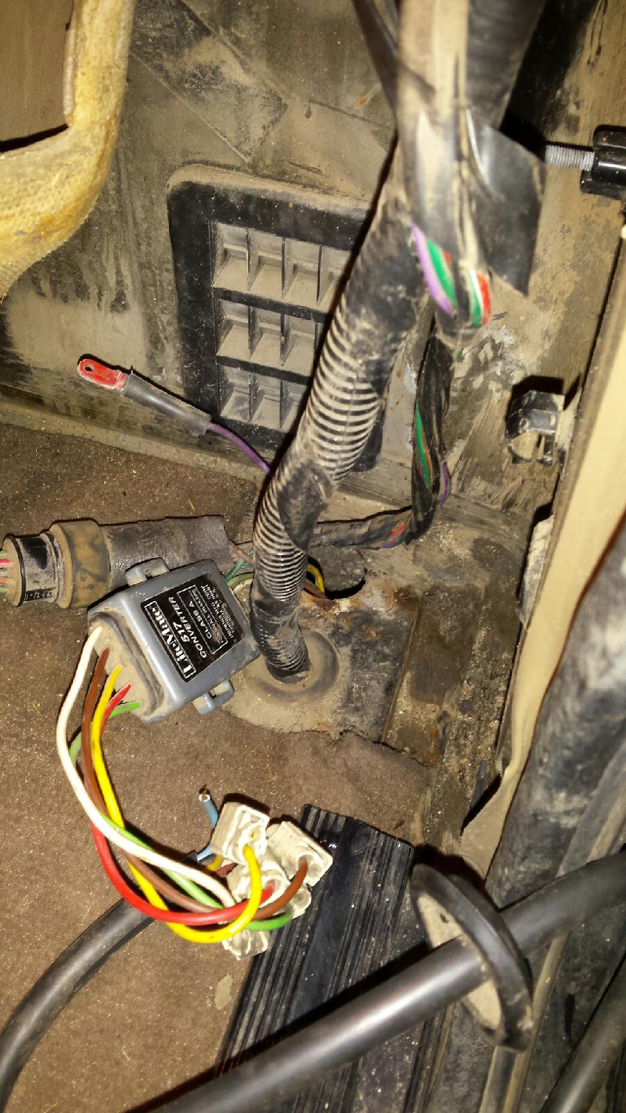

With Headlights off, press the brake and just the right brake light illuminates. Turn on the lights it quits working. Leaving work the day before a co-worker told me pretty much the same thing except that the left illuminated with lights on only, right worked the same, only with lights off... Whoever the genius was that hooked up the trailer lights connection didn't think they need the plug in the pass thru.....
