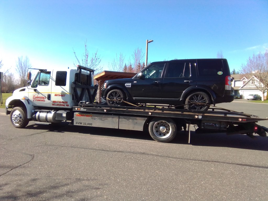

The "Clover Rover" headed off to the (im)pound. Actually, it's the local shop.
