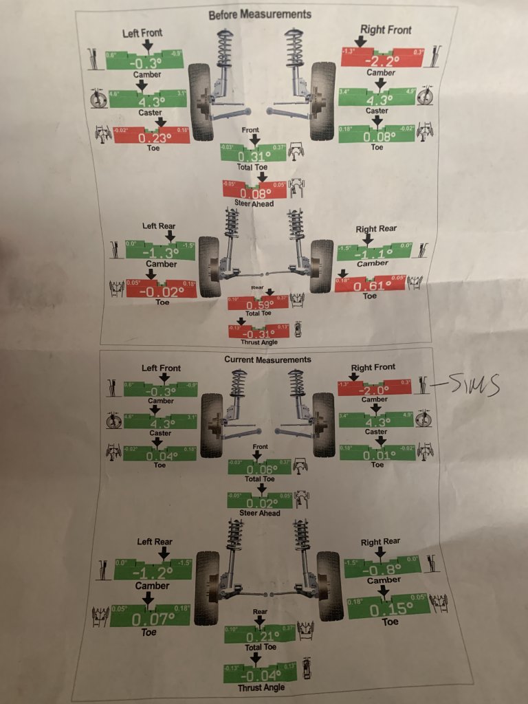

hello all. I went to get my six month alignment done. I had purchased the unlimited alignment package from firestone thinking that since I have an iid tool, and can put it into tight tolerance mode, it shouldn’t be much of a big deal. Anyway, below are the numbers that he came up with after the alignment. I asked about the front right camber being out, and he said the only way to do that is with shims which they don’t do. Is that accurate? I don’t like to jump down people’s throats when I don’t know what I’m talking about. The truck was purchased used and had been in a small accident in the front right which means something could be bent in there I guess. When I purchased the truck I put new lower front control arms and tie rods on immediately as it had the classic “stop clunk”. Should I bring it back to them and say they were wrong or is there something else at play. Thanks for the help.

The photo is of a printout before and after the alignment. The top one has a lot of red but the bottom one only has the one red camber on the passenger front. Tight tolerance mode is designed to lock the suspension so that you can get a more accurate alignment completed. I’ve heard conflicting reports about it but my opinion is if it’s there it’s meant for something. Apparently the dealer uses this when doing an alignment. Maybe someone else can shed some more technical information regarding its functionality.
So, what you guys are telling me is that camber can be adjusted from the LCAs. Like I said, the tech said you had to shim the upper ones to adjust camber. Sounded odd to me but I didn’t know so I didn’t want to argue. I am going to try a different firestone and hopefully will have more successful results.

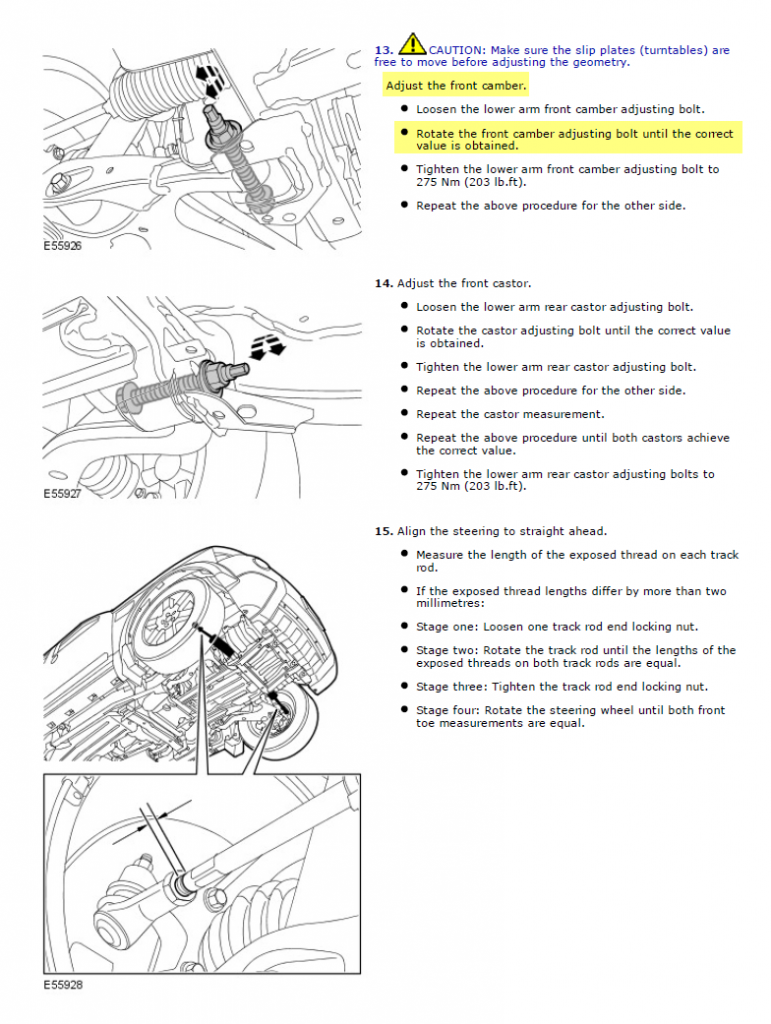

The shop is wrong. The factory manual indicates that camber is adjusted by rotating the control arm eccentric bolts, as Ryan mentioned above. No shims are used. FSM screenshot below.
