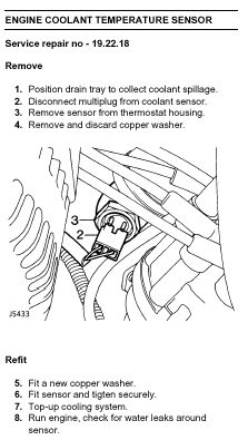

I just changed my valley pan gasket. Check engine light is on, and I have a code 14.
I think this is a bad fuel injection coolant sensor. Need help in loacating it. 1993 range rover.
