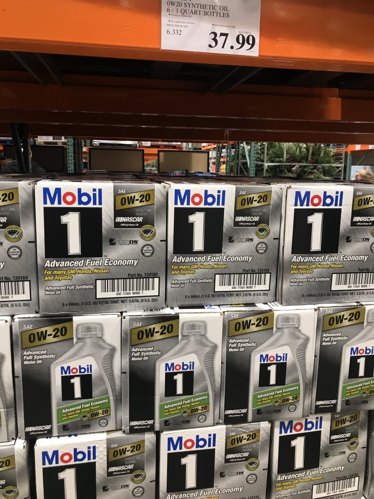

Costco Mobil 0w20
Johnnycakes
Nov 18, 2019
68
Cleveland
Is this usable in a ‘16 Lr4 HSE ?

Last I checked, this oil doesn’t meet the land rover spec. Not sure if it’s been changed.
I have no idea if these special specs on the manufacturer recommended oils is a bunch of BS or not. They do seem to have some different ingredients (e.g., ash). But, if you’re still under warranty, I’d stick with the LR spec oil at least until the warranty runs out.

It's an OK price. Walmart's pricing on M1 EP(extended performance) is better. I've used that for years.
Someone else can chime in with more specifics but the consensus(gathered from countless older threads) seems to be that the JLR spec is not important if you're sticking to 5-7k intervals and using good high quality fully synthetic 0w-20 or 5w-20.

I have made a personal decision to stick with the OEM recommended Castrol which I think it was @ryanjl who dubbed it “Gucci oil” lol. Re price, it comes in at an eye-watering $11-$13 PER QUART so yeah, it’s all relative when you compare it to Mobil1.
Notwithstanding my decision to use Castrol OEM, I change frequently enough that I would not be overly concerned with a different oil spec as long as it was a quality oil (whatever that means). Mobil1 has a lot of fans here and has generated many positive testimonials in high-mileage LR4s.

Normal price is the same at Sam’s club, but I bought 4 boxes on sale for $28. This is what I use but I’m the second owner and only have 46k on the truck, so I’m not a good datapoint for anything but price. :)
