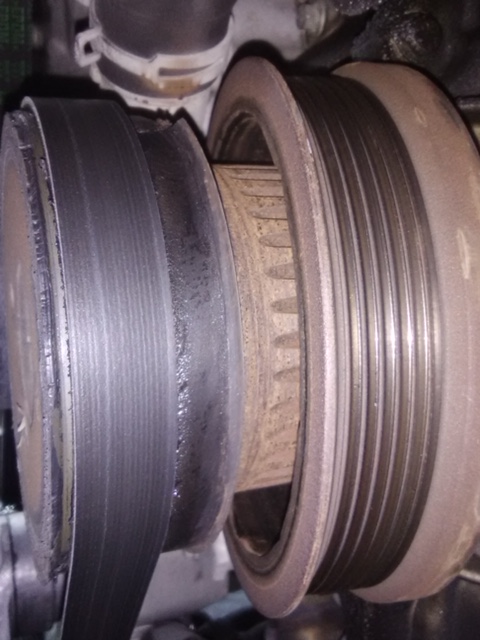

So this happens a few days ago and I start hearing this noise like metal on metal. Well it was. Engine has about 125,000 miles. 06 LR3 v-6. Is this common? I have the part. Should I repair or get rid of it? All else was good. So lucky, blessed whatever you want to call it that the belt somehow stayed on the pulley.
Anybody else experienced this?

That doesn't seem like a costly-enough job to get rid of a perfectly good LR3. Repair it and motor on!
Not sure....there are a lot fewer V6s out there so not as much data, but this is the first I've seen it.

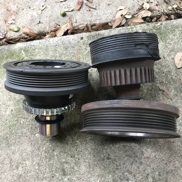

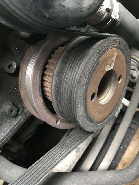

So a friend of mine and I pulled the crankshaft this weekend. The pulley had pulled itself apart as you can see here. I was soooo lucky as the belt tensioner prevented the belt from jumping off the remaining pulley Old and new crankshaft pulley.jpg Crankshaft Pulley part number.jpg

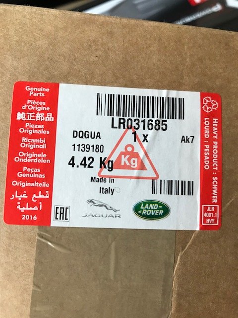

Here's a pic of the box the new one came in. I found a guy at Advance Auto parts, that knows his Land Rovers. It was tough getting the fan off but the pulley wasnt too bad. Be sure you have the correct puller that makes the entire difference. Hope it helps someone. Time for a cold one!!

So a friend of mine and I pulled the crankshaft this weekend. The pulley had pulled itself apart as you can see here. I was soooo lucky as the belt tensioner prevented the belt from jumping off the remaining pulley View attachment 8506 View attachment 8507

so is it two pieces that are pressed or otherwise held together? it looks like they fit together via those splines or is it something else? is the part actually broken, as in cracked or torn metal or is it that the pressed fitting simply vibrated apart or bolts came out?
I just want to know what to look for or if it's also somewhat preventable by tightening things.

The pulley itself is metal then a very hard rubber composite the seems to have deteriorated over the years. The Texas heat didn't help it either. Then there's the innner shaft that it spins on.
The rubber composite appears to be like a vibration dampener. Not too well versed in the design side so maybe someone else can give us more insight in to that.
Like Ian Morrison said above, it may be a preventive maintenance item we need to consider.
