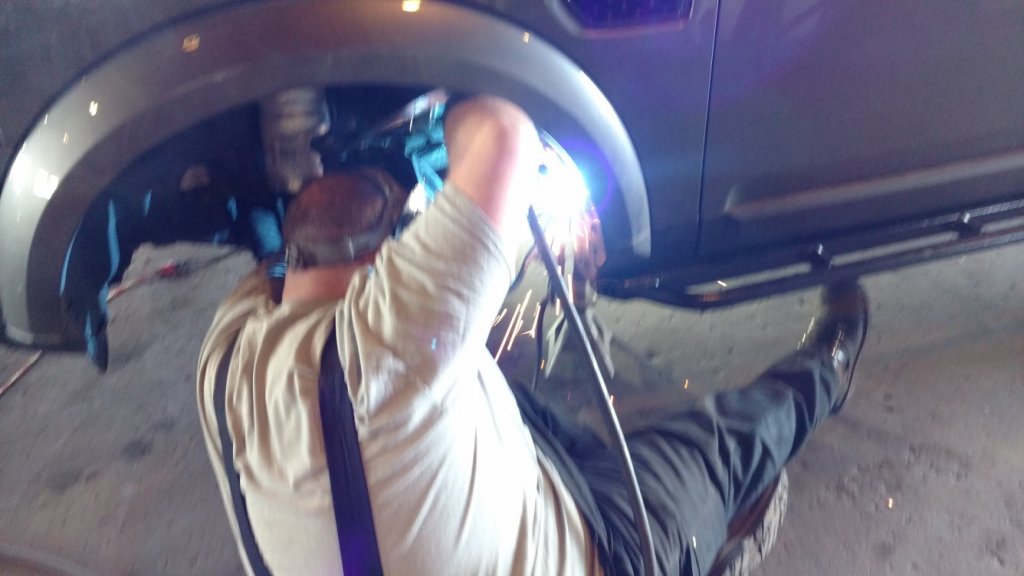

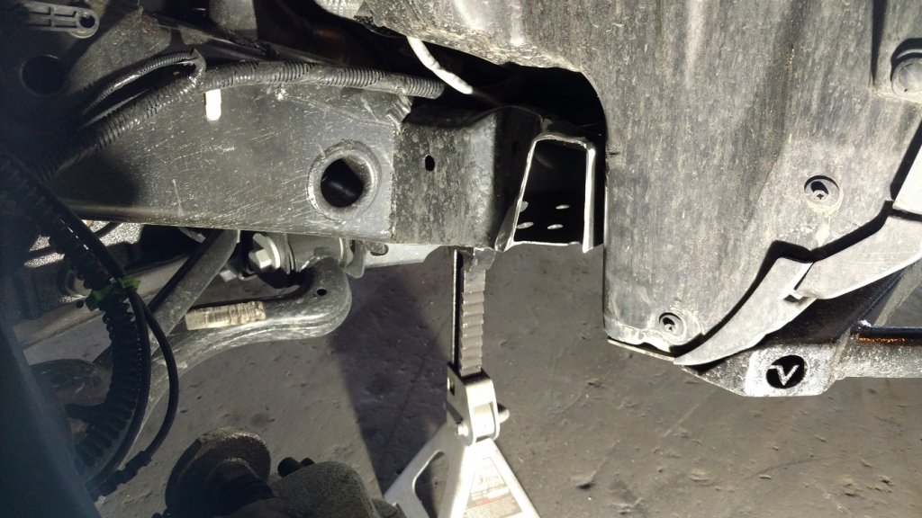

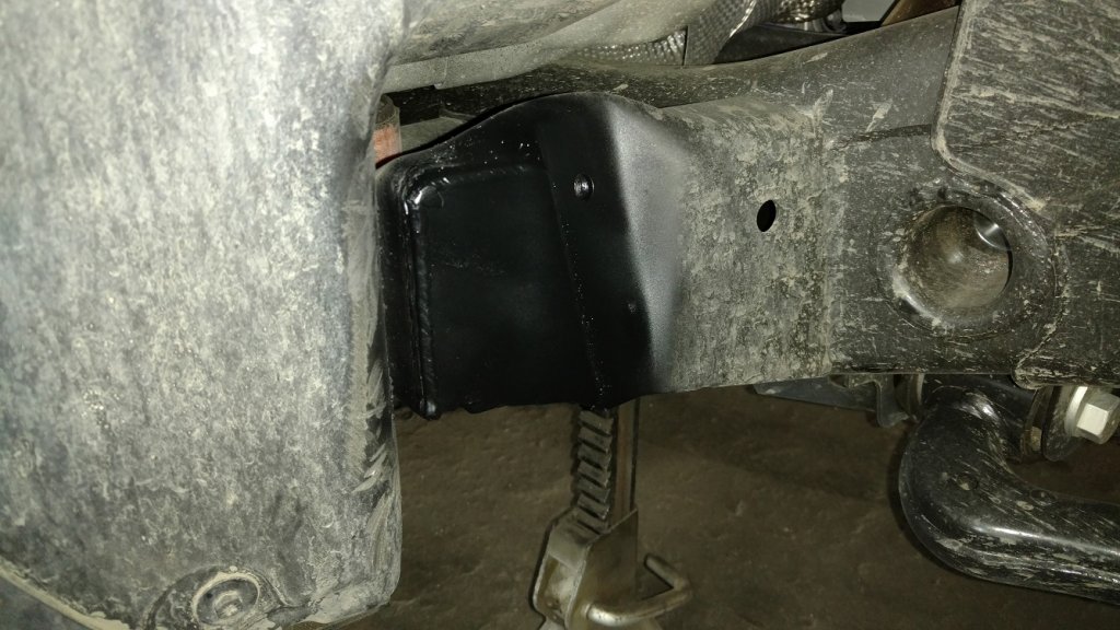

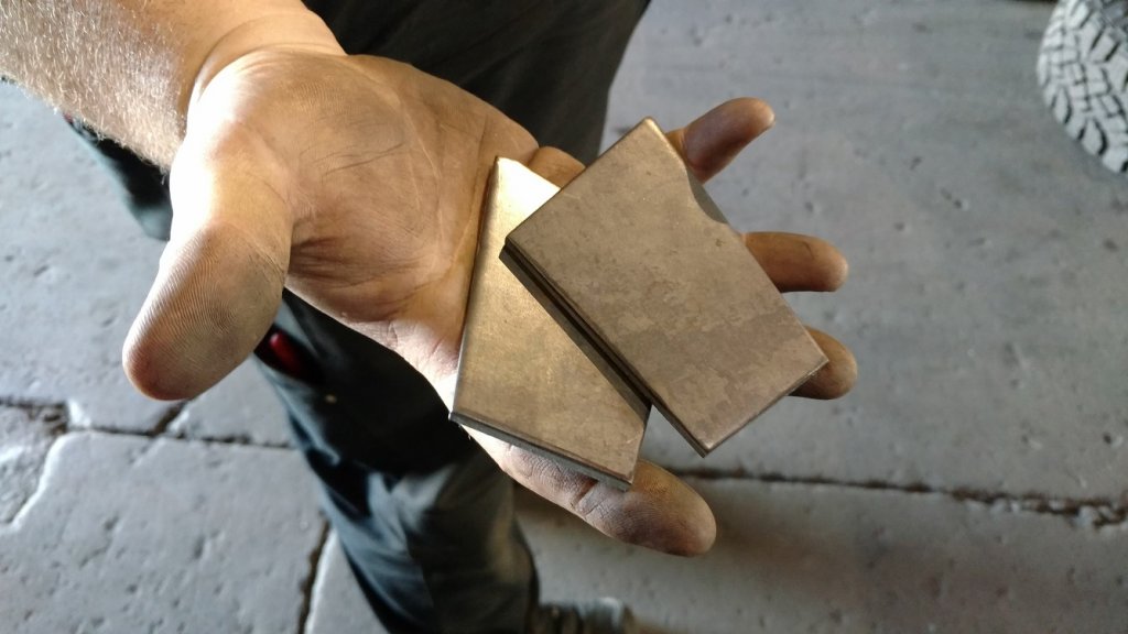

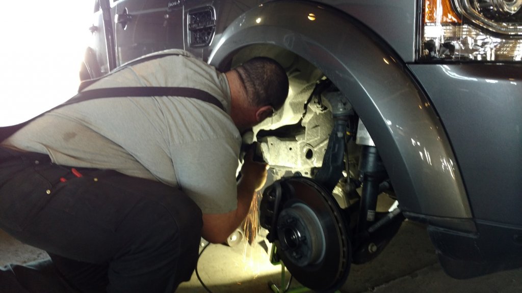

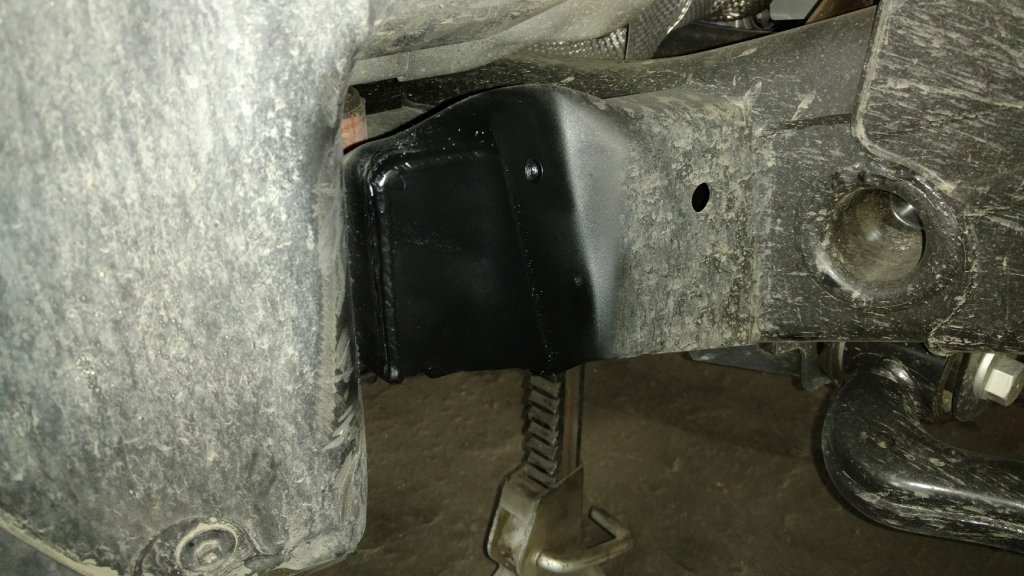

Had this done yesterday. Took a little more than 1 hour including wheel removal and re-attachment.

flush with fender liner, approx. 1 in. Couldn't see much use to go further.

Just FYI, that frame horn is in place to stop the wheel from being shoved into your legs in an off-center frontal collision. I think you could simply trim it back an inch and still fit your tires with ease. I don't know if I would be comfortable going all the way flush to the frame.

That hurt seeing "Hoss" folded up like a pretzel to the max stuffed intpo the well welding it up. Something said about working comfortably standing upright with a lift.
Simple modification. Live dangerously cut 'em back as crossing a street your gambing with death daily......~~=o&o>.....

Anyone know the process for doing this as far as the welding? I’ve never welded on a vehicle before.
I assume you disconnect batteries and have the earth as close to possible to the area being welded?
Any chance a template would be floating around of the fill in piece? If not I’ll measure and post one.
