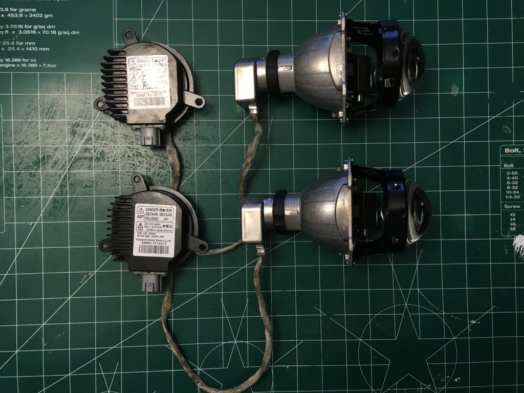

I just completed a full HID retrofit on my ‘12 LR4 Halogen headlights. Involved disassembling the headlights, removing the Valeo H7 Halogen Projector, & installing HID Projectors & Ballasts. Quite a project, but well worth the outcome.
