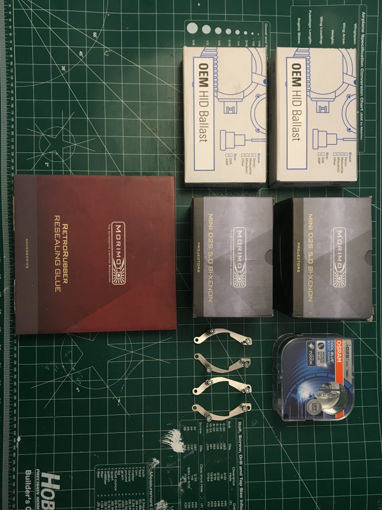

I purchased the ballasts, Projectors, and sealant from www.lightwerkz.net, the bulbs from Amazon, and the projector brackets from a company called “Custom Brackets & Design.”
Here are the parts I used:
- Ballasts: Matsushita Gen V (OEM from Nissan)
-Bi-Xenon Projectors: Morimoto D2S 5.0
-Bulbs: Osram D2S CBB 7000k
Brackets: https://custom-brackets-designs.mys...4-chevy-silverado-d2s-4-0-retrofit-c-brackets
The brackets are actually for a 2015-2018 Chevy Silverado. The Silverado & LR4 actually share the same Valeo H7 Halogen Projectors, so it worked our perfectly.

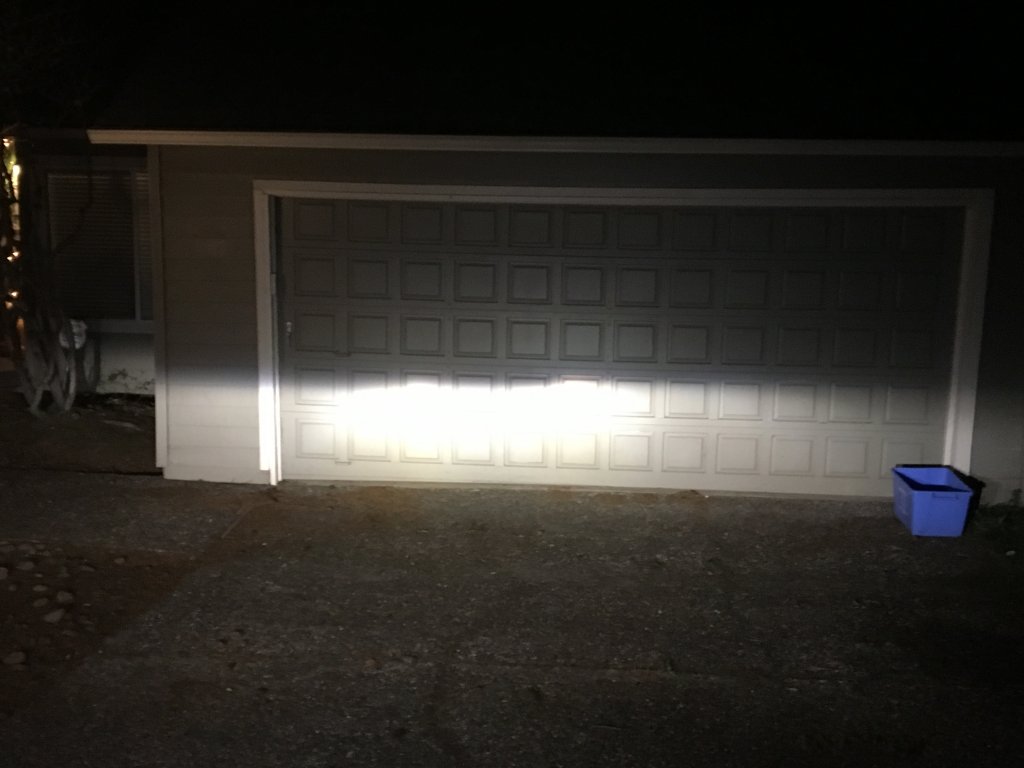

Here’s my wife’s Evoque HID’s and my LR4 HID retro against our garage at 25’. I’ll let you guess which is which...
Wow...that's a good comparison, and thanks for the clarification. I'm surprised the Evoque didn't go with LEDs. What year?
