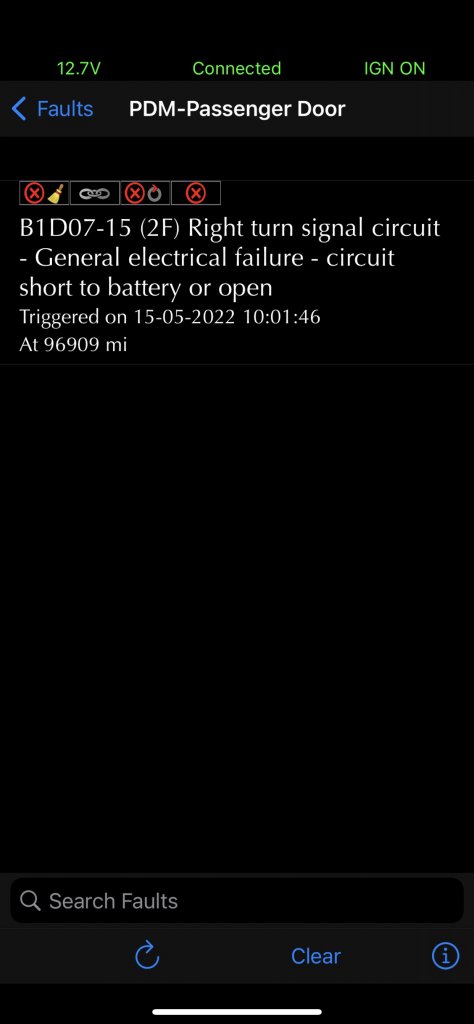

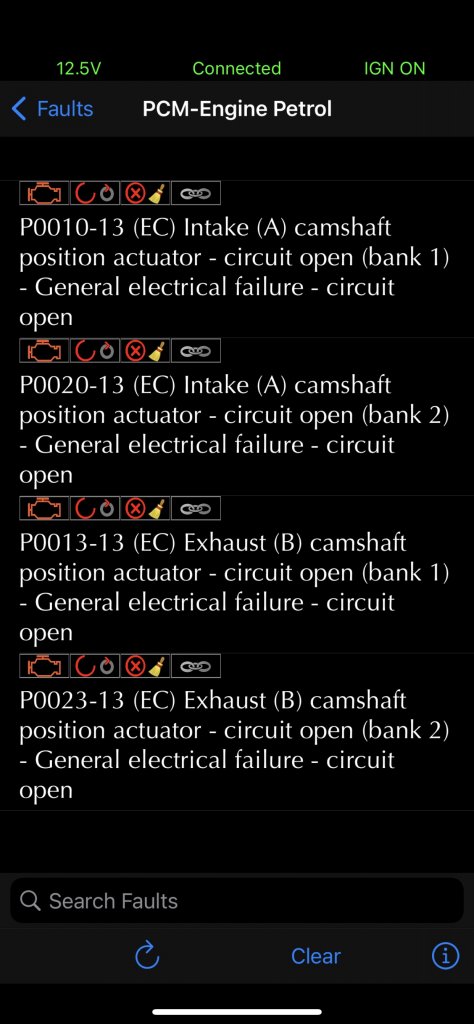

Anybody has luck on engine swap so far? My engine is acting out and been throwing check engine codes which I hope could be electrical in nature. I am hearing occasional knocking sound (tin can) probably from the timing chain guide. I'm attaching the pics for the codes read by my GAP tool. By the way, the check engine light comes up each time I start the car. When I drive the car after clearing the codes, it will not reappear after more than 50 miles of driving until I restart my LR4 again. Please see attached files. Any help is much appreciated.
