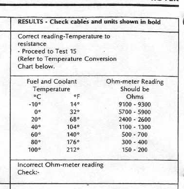

Ok down to business, there is a way of testing the temp guage to verify if it is bad or not. Why not have one of the group test the out put both cold and hot on their temp sensors with an OHM meter and compare it to your both when it is running well and also when it is not starting. This will take all the question out of it???

Sven on discoweb posted this table with Ohms values for temp sensor
