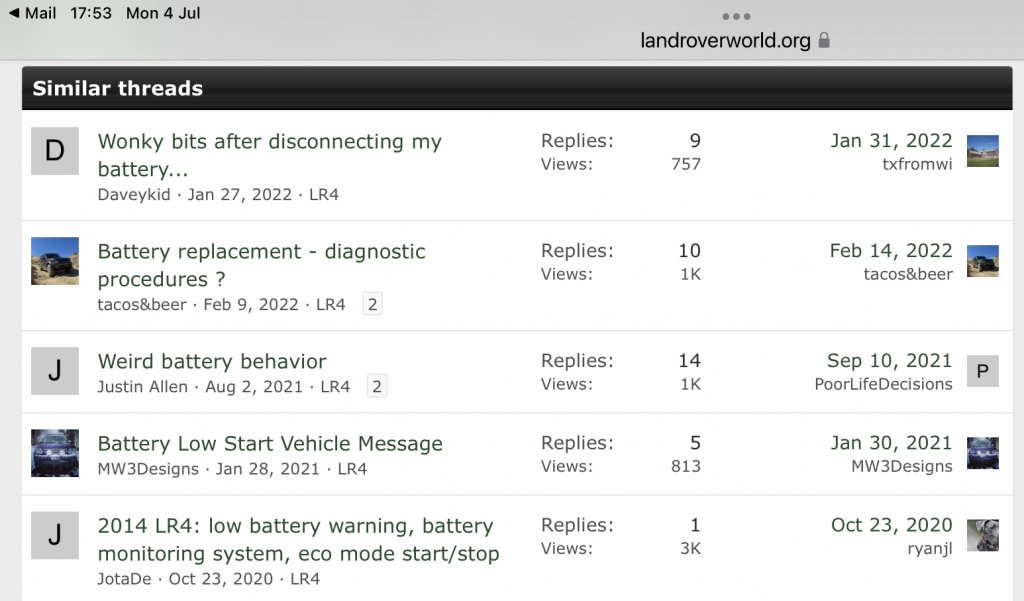

As suggested above & not forgetting that you will need to reset the vehicle charging system in order that system recognises the new battery and doesn’t try & charge it based on the info it retains on the old battery.
Screenshot below shows some other threads that will probably explain better than I!
