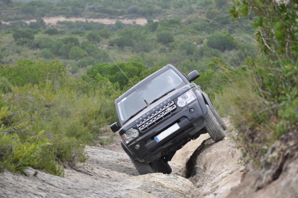

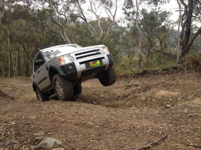

Because of the 4 wheel independent air suspension and its inherit wide degree of articulation, plus the stiff frame and relatively low centre of gravity, the 3 can be found in more difficult off road scenarios. Often only two of the wheels are on the ground and on the rare occasion only one. This means higher than may be common bending forces are applied to a wheel rim or rims; hence the required load rating and why the OEM lug nuts have the washers and are heavier than the usual lug nut.
There are also strong arguments for retaining stock tyre sizes and in the case of the 3, the additional clearance normally gained by going with say 32" is not necessary as there is no front or rear differential hanging down plus the air suspension allows one to lift the body relative to the wheel hub so ground clearance tends to be better than many, particularly when the extended height feature kicks in should the 3 detect that it is grounding.
