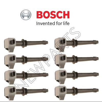

Regarding the Denso vs. Bosch coils, my general understanding with performance coils and spark plugs is that a lot of the "additional spark performance over stock" stuff is marketing b.s., and the only realistic performance gain you might be able to expect is longevity.
Yeah, I'm kinda in the same boat. Looking at the prices online, I can source Bosch Coils for roughly $565:
Or, I can source NGK's for $655:
It's a difference of $90....somehow I though I could source the Bosch's for 1/2 the NGK's, but when I looked closer, it was a set of Bosch plugs and "OE replacement" coils that they did their best to hide the fact weren't Bosch. Darn eBay junk peddlers!
I'm leaning toward the NGK's as I've always had good luck with them. I honestly don't think it'll make one lick of difference in fuel economy or power output. Maybe they'll just last a little longer? That said, my LR4 is a 2010 and it still runs fine with the original Bosch coils....so longevity is definitely a relative term. :hmmmm2:
