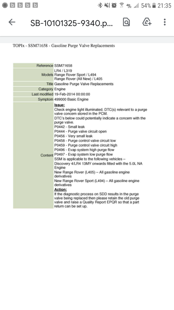

There is a TSB on the purge valve with that code. If I remember right, it was not an expensive part to replace.

I wanted to close the loop on this in case anyone else has the issue in the future. Michael's suggestion via the service bulletin turned out to solve it for me. After all the back and forth with my shop, changing the purge valve myself cleared it up.

I got the purge valve in today. Sure enough that was the fix. Filled up right after and no further issues. Thanks for posting this Michael and Brizzity!

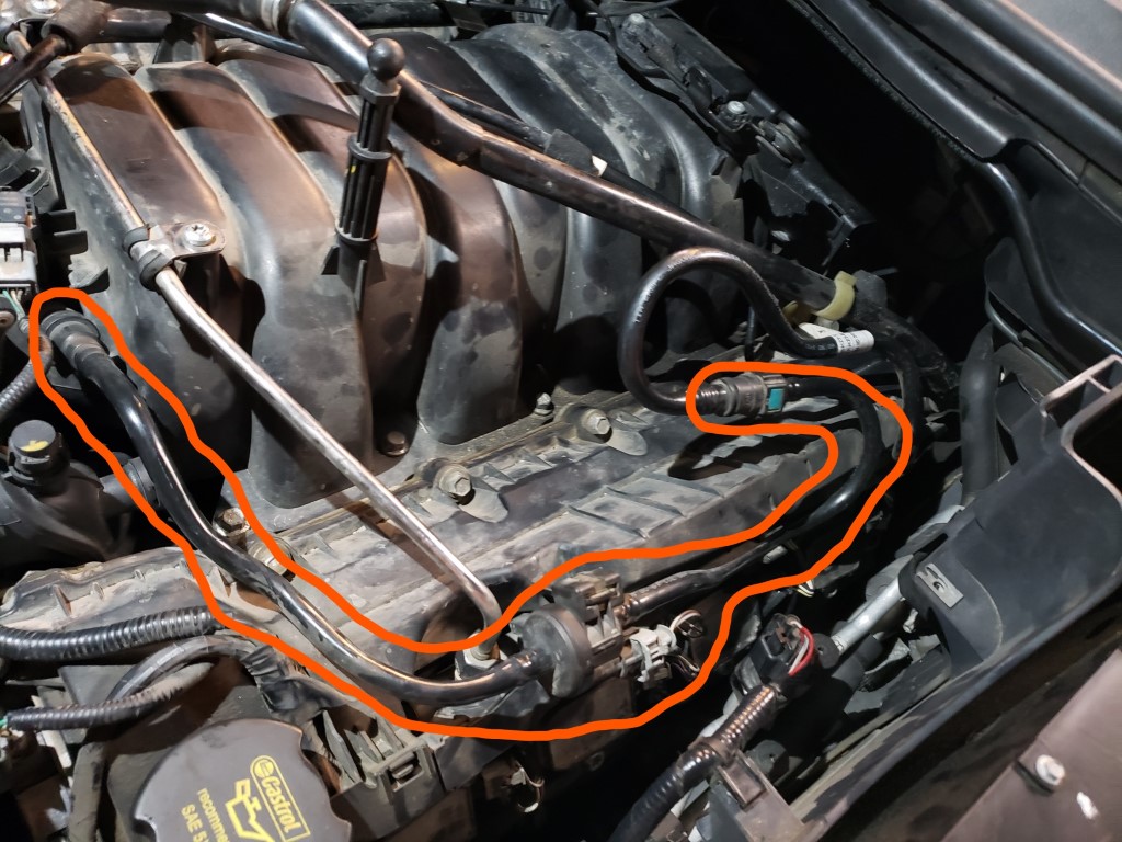

Waiting on this part myself. Where is the purge valve located? I can't find a single picture or diagram on it.

Long black tube runs from throttle body along drivers side of engine and then down behind the engine. The tube has a smaller diameter (as I recall) than the breather. The purge valve is in that run of tubing in the engine compartment. Might be tucked under the flexible shielding material.
