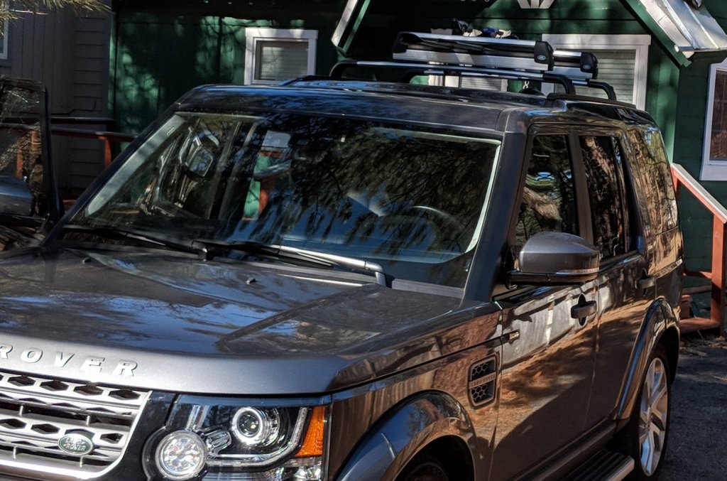

My 2016 didn't come with any rails either. I only ended up buying the short rails (actually preferred the look of them over the long rails), cross bars and the Land Rover badged ski rack which happens to be a Thule product. I couldn't (and didn't want to) reuse my old set as they were well past their expiration date.
As said above, removing the clips to prepare the surface for the rails can be a challenge. However, I found by taking my time, and using some plastic pry tools, they came out pretty easily.
