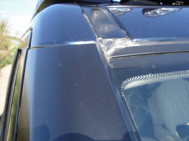

Per the link below to disco3, is a thread re running conductors either up the A pillar or up behind the tail lights and back along a rack. Lower down in the link are quite a few pictures of where to run the conductors and wiring disconnects and relay installations.
http://www.disco3.co.uk/forum/topic53176.html?highlight=+antenna++mount&start=15
