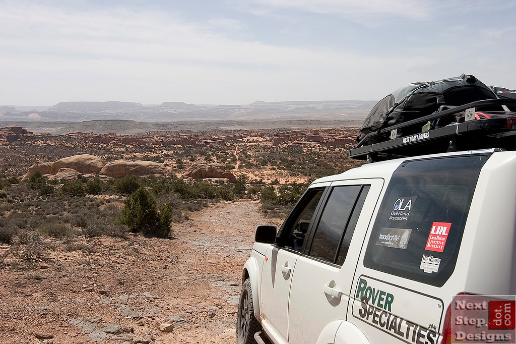

I did use the yak towers, now in 6 locations. I cut the bars to fit within the width of the side rails so the rack snugs right down on them at the 3 stock rack mount locations (you could attach differently but this lined up with the lr3 fine) Ideally the front needs a taller mount than the rear, I made a temporary height fix by using another cross tube to gain an inch.
They are secured to rack via grade 8 thru bolts and lock washers. I can remove the entire rack and bars and mounts in one piece though which has been nice for spring cleaning or if sunroof work needed to be done. My roof lighting all unplugs via a single trailer type plug at the rear.
I am most likely overstressing the yakima parts but it's been fine so far. We have since decided to never have the tent up there anyway and put it on a trailer instead or camp with normal tents.
The air damn is the Thule version and simply mounts to the front rack edge. It reduces wind noise to a minimum although a custom made molded thing would be nicer.
