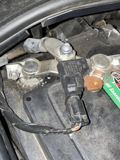

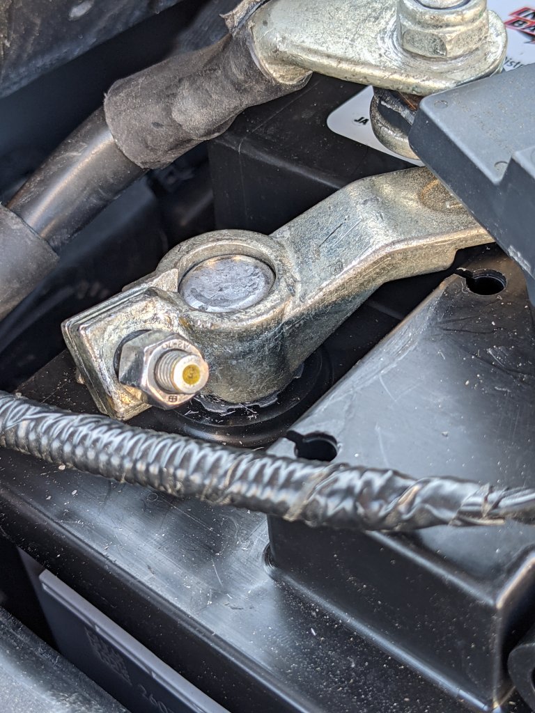

Do you guys know what the proper (negative) battery terminal connections are supposed to look like? The original positioning seems off and the negative terminal didn't seem like it was getting a tight connection. I've moved it around a little already. There seems to be a notch where the main steel part can sit up against the battery, but there doesn't seem to be anyway to position it so it can line up there.
My dash lit up and went into limp mode. Pulled over rested and restarted and it went back to normal. I'm at Sepulvida LA Costco now and I'm trying to connect a new battery. Trying to get back on the road for my stay at Pismo Beach on the way back to NorCal.

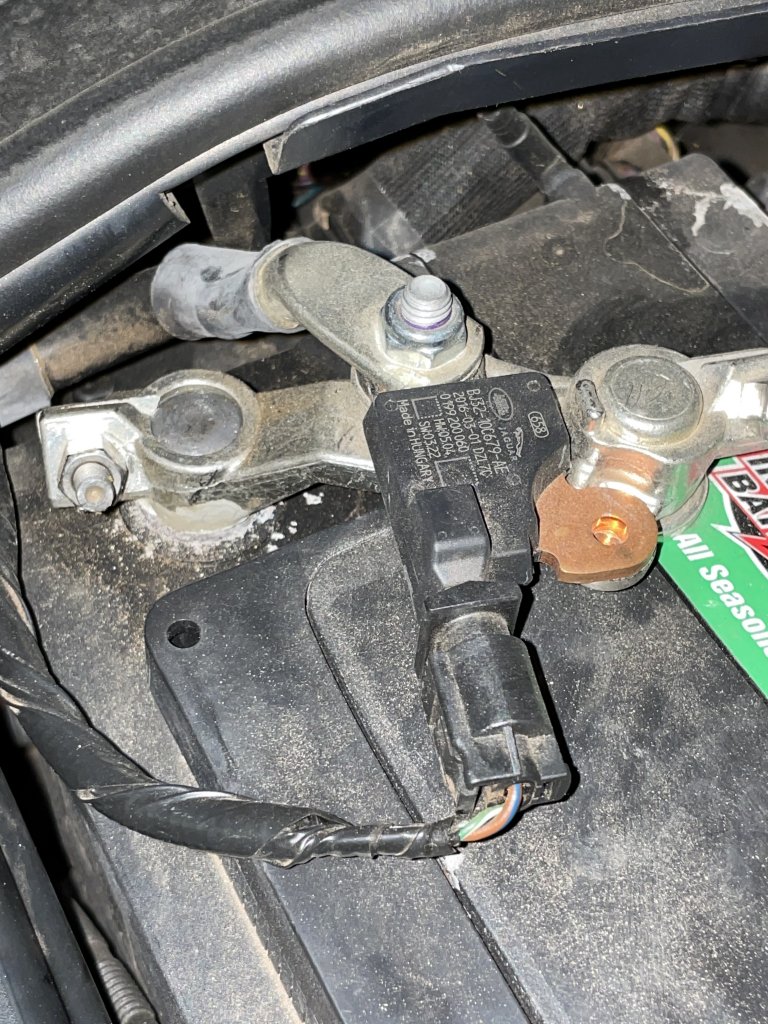

Thanks for the quick reply! I positioned mine that way, but can't seem to get it down as low to post as yours. This is the lowest I can get it.

That should not make any difference. Looks like plenty of contact for a solid connection. Are you still having issues? Do you have a scanner? Sometimes a code gets thrown that needs to be reset. If you don’t have one, you could see if the costco auto center guys have one you could borrow. Or maybe there is a auto parts store nearby.

I'm thinking/hoping the limp mode was just due to loose negative connection. I did a hard reset awhile back and I don't think I tightened it enough, or week enough as I just did now.
