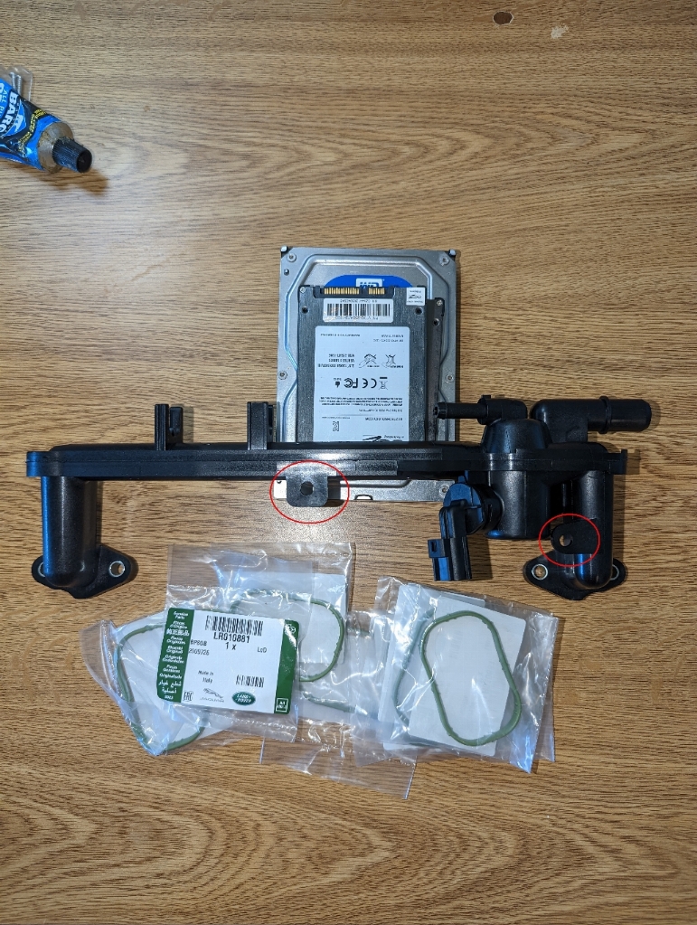

I grabbed a parts list from this site and spent over $1k, plus the hatch mechanisms. A bit more than I wanted to spend since I'm replacing the entire engine in 2.5 months. I can return the parts I don't need so that is a relief. The parts guy threw in some extras like the other two crossover pipes (one is no longer a pipe?).
I'm trying to plan how to accomplish the repair before tacking the project. I went through the service manual last night and I was thinking about buying a stool or whatever to stand on but realized I could drop the suspension, lol. Maybe that will give me enough reach.
I have the right torx socket now for the bolts at each end of the flange (for lack of a better term). I'm curious about two other mounting holes on the pipe that are circled. The center one and another mounting hole on the right. Are there bolts for those holes? I'm trying to figure out what is mounted there.

Those holes are for plastic press-in fittings that hold electrical wires in place. You will pop them out of the old pipe and press them into the new.

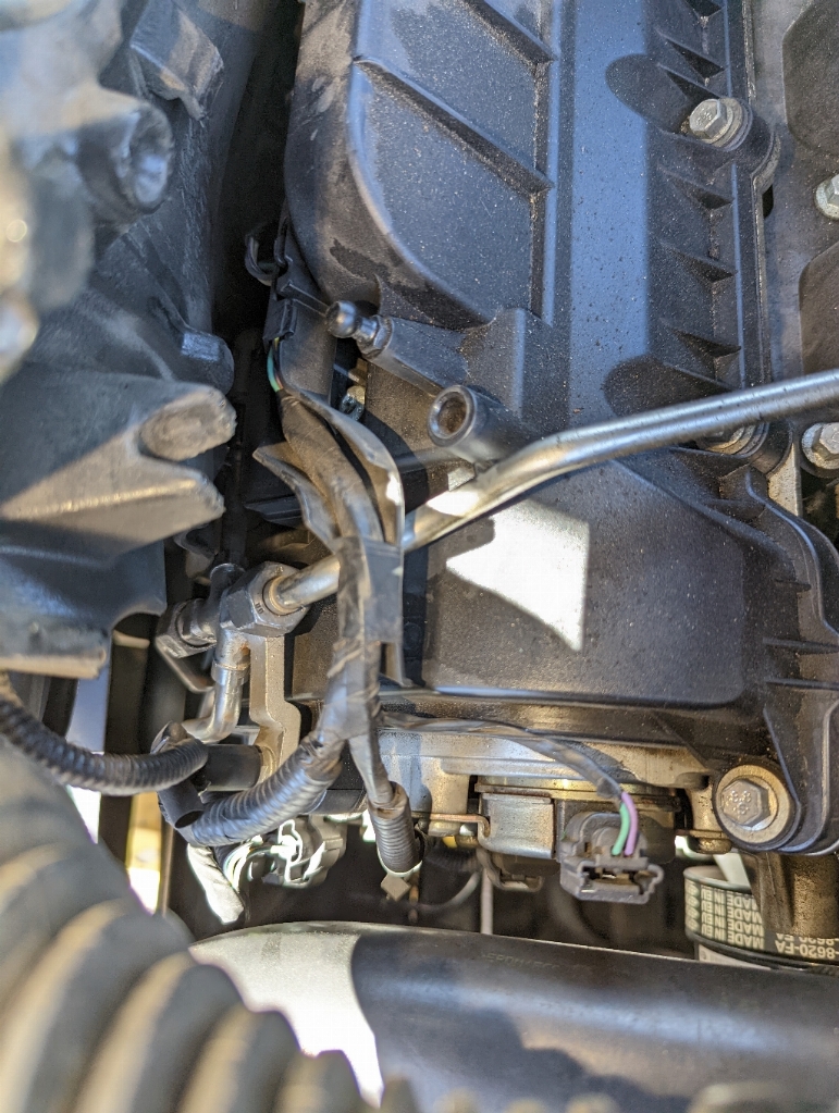

I'm waiting for my engine to cool off after a parts run and just verified the tools I bought fit before tearing into it. It looks like I found the right size wrench for the fuel line for anyone else doing this job in the future, 17mm. The drivers side fuel line nut looks a little tight. Is the wrench I bought too long?

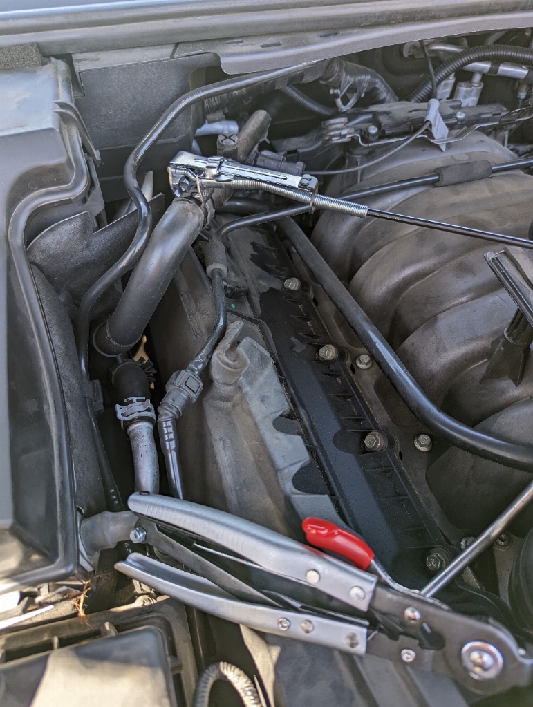

I found the hose clamp tool and also got 2 gallons of dexcool. I hope that is enough. I plan on putting a catch bin down underneath and just let it leak out as I remove the parts lol. I picked up a hose pinching tool that looks like scissors, but you pinch the hose and it locks closed. Maybe that will cut down on some leakage. It would make sense to drain the entire cooling system properly and put fresh fluid back in if I were going to put some miles on this engine.

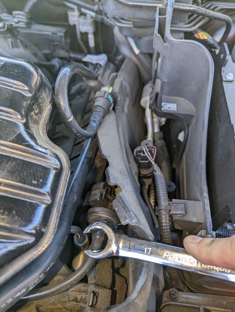

In the first pic it looks like I can remove the rubber cover and that diaphragm looking thing with a tube needs to be removed or moved out of the way for the fuel line wrench to get into that area and swing back-and-forth to loosen/tighten the fuel line nut. It looks like the box on the right side will be in the way too. What all needs to come out to get that nut loose/tight? I'm going to crack the passenger side 17mm nut first with some rags and a catch can if needed to get any fuel that dumps out. That line conveniently happens to be a low pressure fuel line, there is another high pressure line somewhere else.
passenger side nut that is also 17mm and easily accessible:

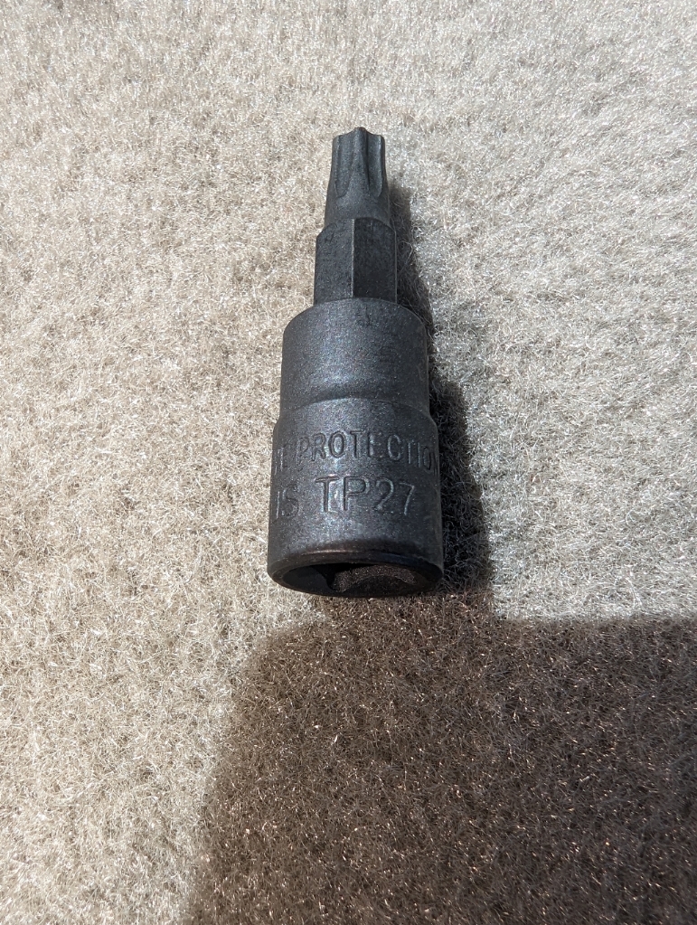

This is the torx TP27 for the crossover pipe mounting bolts:
