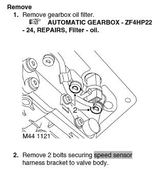

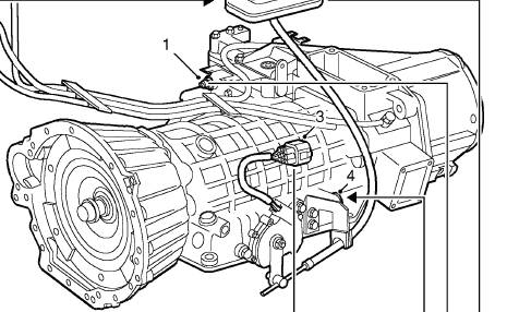

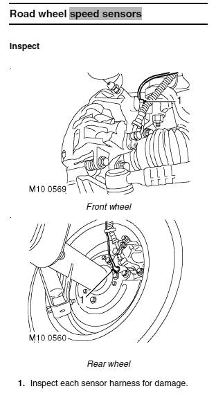

Does anyone know where the speed transducer is located on a 2002 Disco II ? Is there an easy way to change it out? I have the part, but the Rover manual is not really very descriptive as to the location. Help...speedometer does not work.

Hope this helps.
