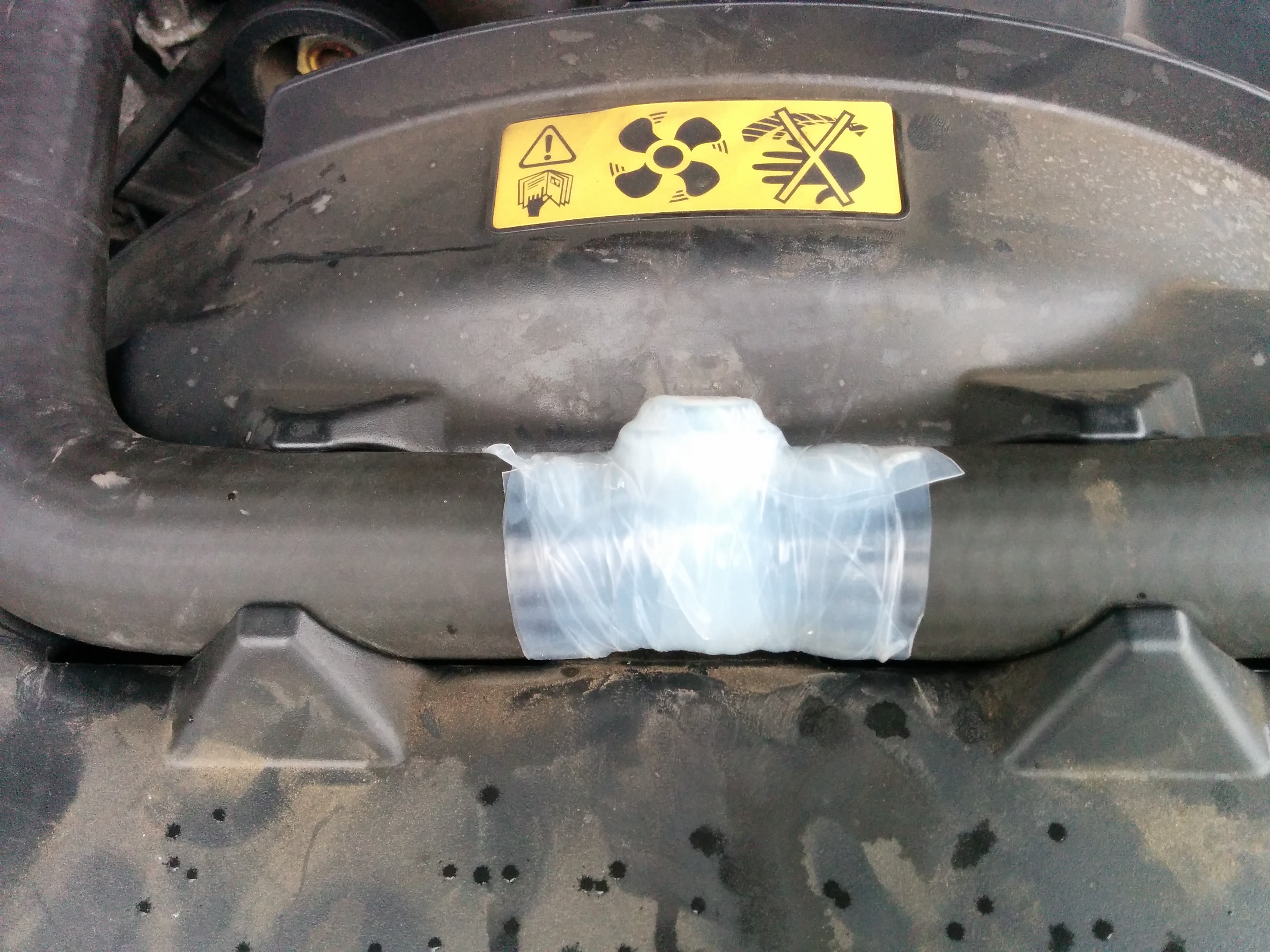

Here's what I did...
I glued the screw cap back onto the valve seat using Loctite gel then wrapped the whole thing with several layers of Loctite self-fusing tape (see pic). Put the hose back on, hoisted the reservoir up high, topped-off, ran the engine for a bit with the cap off and the heater on max, then topped off again. Everything seems fine. Running cool and getting good heat and no waterfall sounds.
I can't get the new hoses in from Atlantic British until after the holidays at this point. Will my fix suffice for the next several days? Or should I take it to a mechanic to see if he can do a more robust temp fix? Maybe have him just replace with a fresh generic hose today until I can get the right one?
FYI...those are just rain drops in the front. :tongue:

Ahhh...yeah I guess that would work. Hadn't seen that one before.
But it still wouldn't matter. Once the screw sheared off, the other end was still inside the other piece of the valve that sits inside the hose. I had to get that out of there, so I punched it all the way through, then removed the hose and it fell out. Tried to get the rest of the screw out and the whole thing just fell apart in my fingers. Completely corroded.
So there's nothing for that screw to thread into.
Oh well, I took it to my mechanic and he said what I did is fine. He thought it was just scotch tape at first and gave me a crazy look. Then he felt it and said, "Whoa what kind of tape is that? That's pretty great stuff." Said that if it didn't blow when I first started it, then it's gonna hold up fine for now. Going to order the new hoses from roverparts and have him install everything after the holidays.
Seriously...Loctite fuse tape is really great. I'm going to buy a case of it and fix everything in my house.
