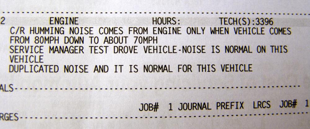

My LR3 is generating strange humming noise from engine (area) when I let go the gas pedal at 80mph. I only hear that until it drops to 75mph. I took it to LR dealer and they said it happens to all LR3s. Is it true or they just don't want to deal with it? Did anybody experience the same thing? - Brian

It's not that loud but loud enough to be noticed when you drive with music off. Hope it's something that goes aways later time. Now I know it happens, it became quite annoying... - Brian

Actually, mine only generates noise but not performance degration. And most of all, the dealer didn't do anything but saying "it's normal"
