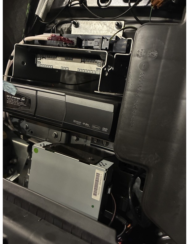

I have a buzzing/static noise coming from the speakers whenever I switch to the AUX input. As soon as I plug in a jack cable, the noise appears. It seems much more noticeable through the upper speakers than the larger lower door speakers.
What I’m Installing​
I’m currently installing an external CarPlay module. The module taps into the OEM Satellite Receiver/Radio Module located in the passenger footwell behind the fuse box.
Here’s the module:
https://unique-ad.co.uk/product/wir...-l320-range-rover-l322-discovery-4-2009-2012/
It’s actually a really cool system, and I’ve already installed the exact same setup on two other L322s without any issues.
The system requires using the rear AUX input (rear entertainment media AUX connection in the back of the center console) in order to feed audio from the CarPlay module into the factory audio system.
Most importantly: I’m 100% sure the issue is NOT coming from the aftermarket module itself because the noise remains even after completely removing the CarPlay setup.
What I’ve Diagnosed So Far​
  • I swapped the rear entertainment AUX input module (rear center console unit) with another known working unit from a different car. The noise remained.
  • Even when I completely unplug the rear AUX module (both connectors disconnected), the noise is still there.
  • The ONLY time there is no noise is when nothing is plugged into the AUX jack.
  • I removed the AUX fuse (I believe fuse #51), and the noise disappeared.

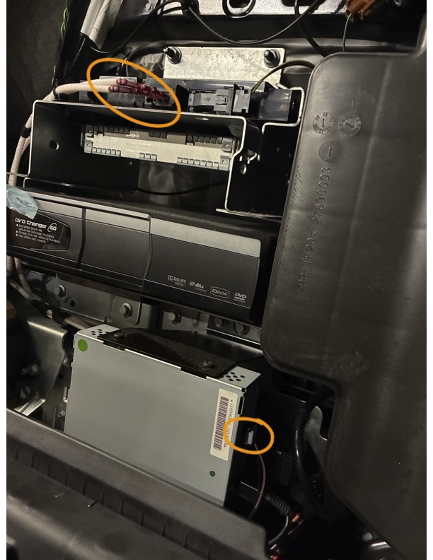

  • When I unplug the second connector from the OEM Satellite Receiver/Radio Module (which I believe may be the speaker output connector), the noise disappears again.
  • If I disconnect any fiber optic connection from the MOST loop (rear trunk/CD changer area), the noise also disappears — but then of course I lose audio completely.
I circled in RED the connector where unplugging it stops the noise.
