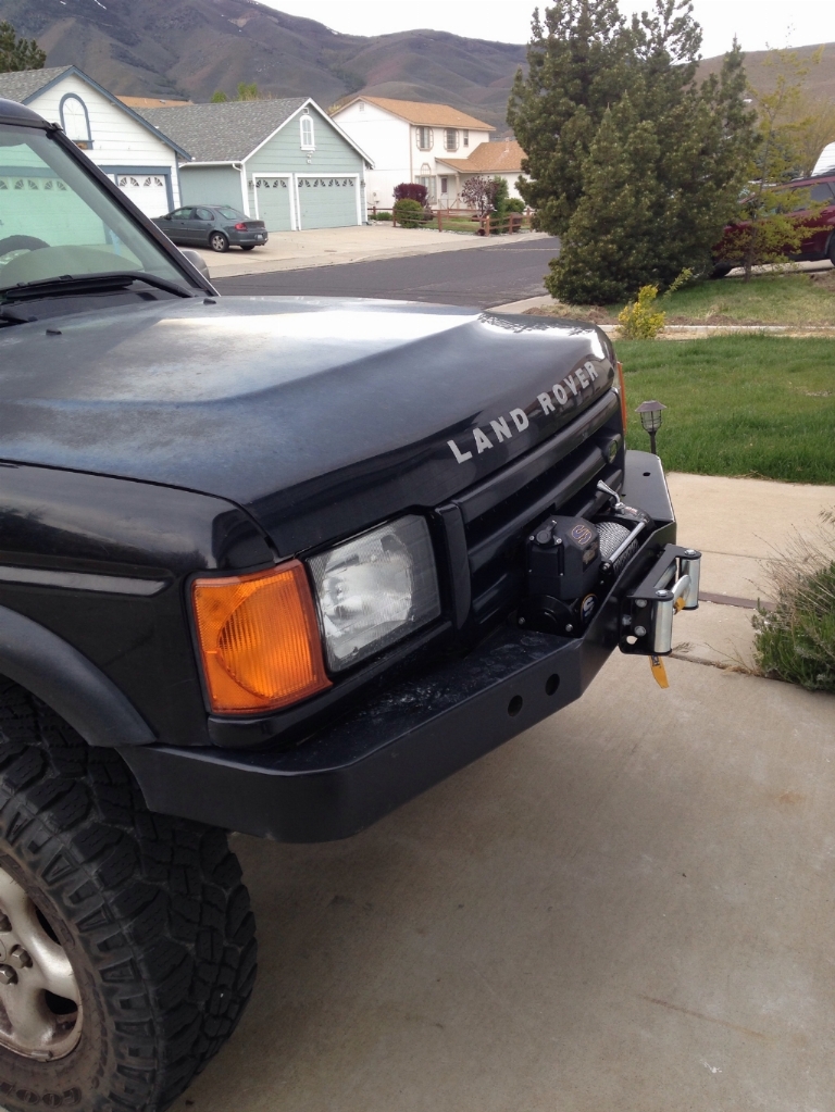

Coil was changed 20k ago. 02 sensors 10k ago. Maf still stock, 100's of other add on's. Installed new winch today
evansjoem
Jun 23, 2015
43
10k superwinch $275 Amazon

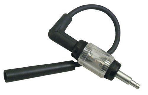

Buy a spark tester if you can ($5-8 see pic), easy do it yourself Tool to see if the Coils are working.
