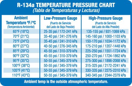

For you GAP IID users, with your A/C on "LO" mode, what's your high side A/C pressure (and ambient temperature for reference)?
If you have A/C manifold gauges, what's your low side pressure?
I just checked my pressures with gauges and IID tool and both maxed out at about 1000kpa / 145 psi on the high side, and my gauges read 200kpa / 30 psi on the low pressure side of the system. This is at 95 degrees F ambient.
I've been learning a lot more about a/c systems this week but have a long ways to go. Can anyone shed light on normal ranges I should expect to see? Does the LR4 variable displacement a/c compressor present any considerations when checking pressures, or should things correspond to the "normal" r134a refrigerant charts you can find online (sample attached)?

Many people go by the static pressure chart readings of air temp vs psi numbers which are the same in the system at static full charge or very low having the same psi readings. Temperature pressure laws of R134a gas.
Next they get a can with a gauge and recharge thinking all is good, they also added R134a with sealant additives this the death of any AC system. No shop will service a system with that crap damaging their evac equipment. Read the cans, larger bottles do not have this crap in it. Recharge with cans having only R134a in it NO SEALANT.
Variable compressor output, check the factory specs for this system's pressure numbers what is normal for high and low side readings.
R134a has a tight range of operation in lbs and oz. installed with a narrow under or over charge amount of specs as your AC will get warmer again being under or over charged.
