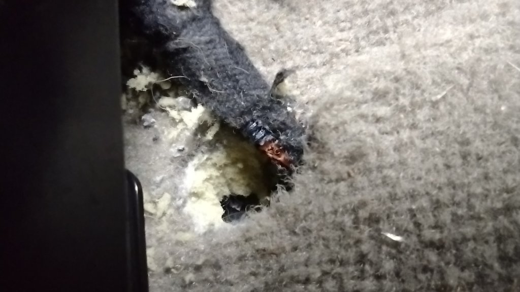

Anyone have experience repairing/splicing the most fiber connection? Center dash screen stuck on LR logo, no controls of audio/nav or backup camera.

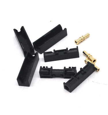

Thinking of using the brass splices you can buy online. Here is the terrible pic of the wire. Can see red light when truck wakes up. So that can't be good. Pulled a fiber loop from an LR 4 so I have a long jumper if I can just do that. But that entails pulling most of the interior out.

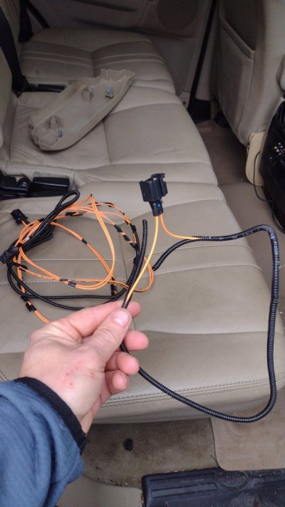

Already on it Went to u pull yesterday and got the harness from radio to rear window area from an lr4 ( tore that thing apart, and dread having to do that on mine) made long jumper and short test lead. I get light after the chew spot, and the loop did nothing. So either something downstream of amp, or there's untenable loss from the chew. That's one thing I don't know. If I see light after the damaged area, does that mean I'm good to go? Or is enough light lost that the signal is rejected?Dunno.

Welp....359 degrees later, I'm just about where I thought I'd have the problem. Prior to dealing with fiber optic " Christmas lights type" one unit fails the others fail too.
Yep, all rear modules checked, bypass the under seat amp ( what I initially thought) and blinking whet to solid red. Dash screens back, just no audio. So nav and backup camera work.
I'm going to say it's the amp....anyone disagree?
The chewed up wire....just noise.... unrelated it seems

Land Rover dealerships have a repair kit for the fiber optic cables. Basically inserting a male and female connector where the break is.
