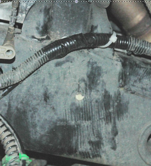

Now for my thread-jack...where is everyone relocating that wiring harness in the driver's front wheel well to? I have tried tying it back, which just comes loose and ends up doing nothing, but there doesn't seem to be much slack in those wires to relocate them. Are you guys cutting them and adding length in order to relocate? Thanks in advance.
/thread-jack
-Paul
Here's a photo of where i put mine. You can also see where they were rubbing. Actually cut a few of the wires causing Check Engine light. I repaired the wires and the light went out.

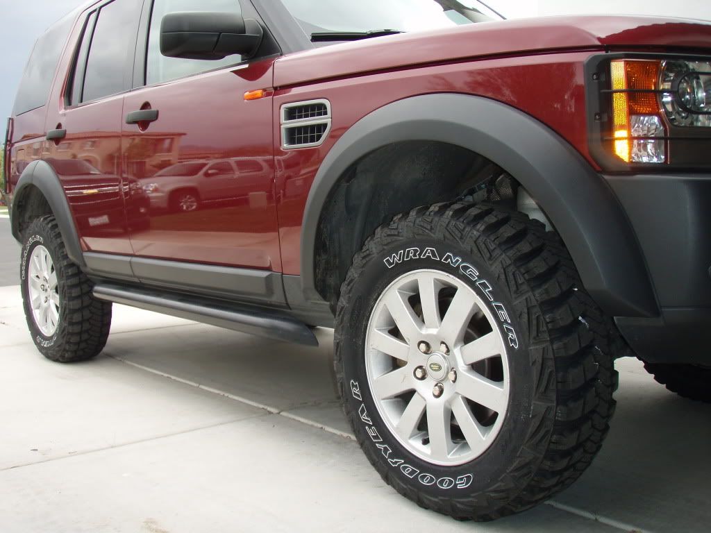

I run 32" GY MR/R with kevlar 275-65-R18 and have no rubbing. I did tie up the wires with a zip tie as they rubbed prior to the lift with my old tires. The 285-60 will rub off road with no mod.
