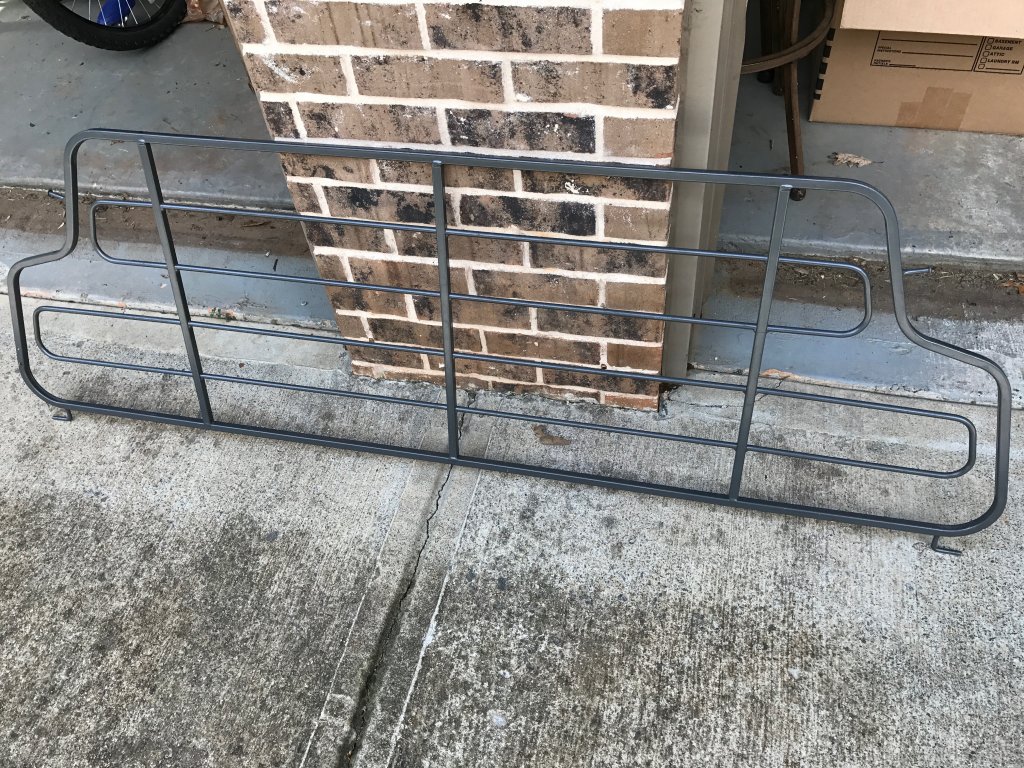

Here is the picture of my dog barrier that I sent. Note the pins. I don't know the part number for this
style dog barrier.

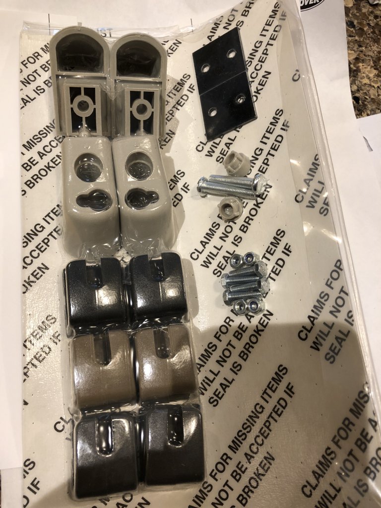

The kit that came looks like this and has part number STC50231 and from what I remember looks just
like the parts that I had in my Disco.

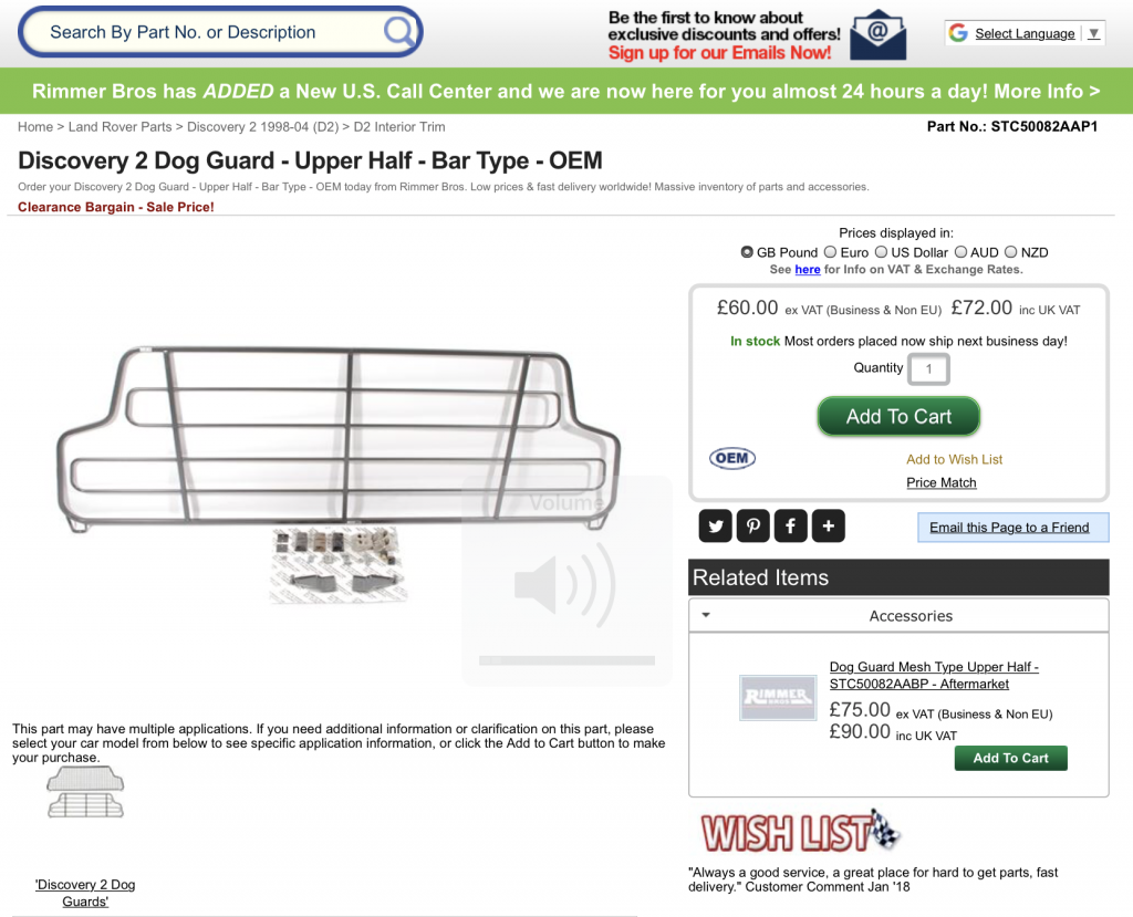

It seems several people have mixed one dog barrier type with the wrong style kit but I was never able to find a thread where the two correct ones were combined. The only thing I could find that supported my feeling that the above two belonged together was this barrier and kit for sale. This is what I suppose is the newer type and kit has the arms added as you can see in the picture.
It looks from this image the part number (for the guard) is: STC50082AAP1 but I'm not sure if that's
LR's part number or Rimmer Bros.

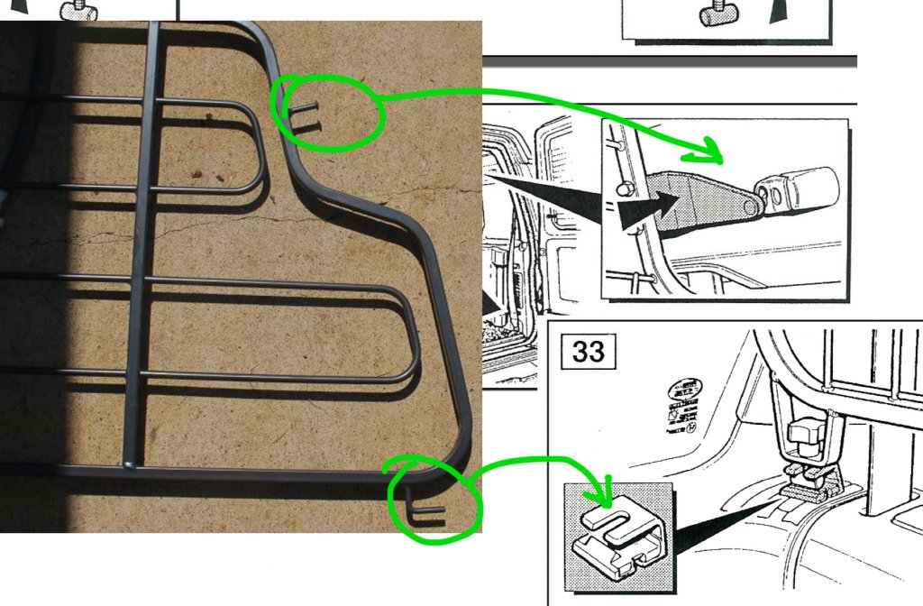

So based on that image, the kits look almost identical with the difference being how the barrier itself is attached. Here is how mine attached. The images are pulled from the install directions.
Basically it looks like the newer add on pins take the place of the built in pins. My guess is the newer one is more secure due to the screws and has less of a lean based on the angle of the added pins as mine would have to tilt back in order to drop the pins into the slots.
