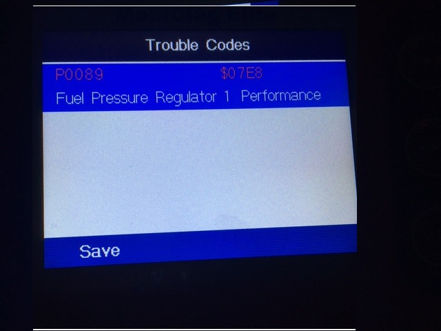

I would order an OBDII fault reader from Amazon. You can get them fairly cheap (about $50) but I ended up getting a more advanced one that could read and graph live data. Still cheaper than a IID tool and you can use it on any car with OBDII. I was getting an intermittent check-engine light that I wanted to figure out before bringing it in for service. I don't have much experience with engine diagnostics but the good news is that even when the light goes out the fault code is stored until manually cleared.
I was able to determine the issue and, fortunately, have the dealer tell me the same thing. It was fixed under warranty.
