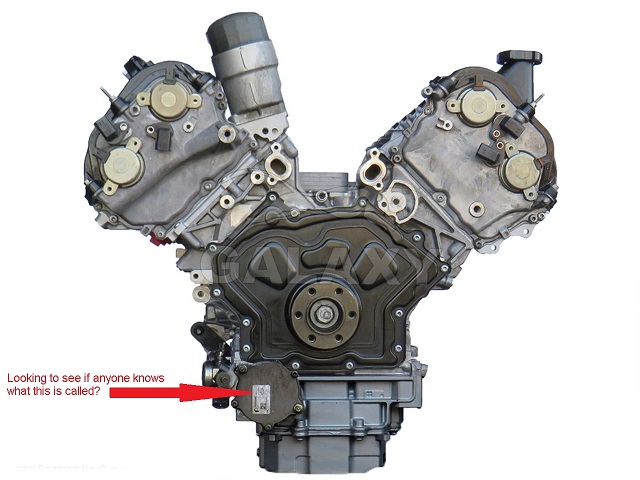

Hello everyone, looking for some help. I have a 2013 LR4 and it has a small leak, put it on the lift today and discovered the leak coming from the back of this part where is it seats agaibs the block. Not sure if this is a comon issue or not. Thanks for any help you can give.

That is the engine vacuum pump.
It is common for them to leak oil.

Just replace it.
There's an internal o-ring that can leak, allowing engine oil to be sucked into the engine.
