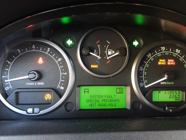

Then I go to my LR3 - start the engine in park - hook up the iiDTool - and all the warning lights come on and it gives a bunch of faults that were not there previously based on what my mechanic told me (is it running through the possible faults?). Nothing comes up on the Interface in the car (it gave me a transmission fault - that the cruise control was disabled - don't know if this was there before) and then I don't ever see the iidTool come up.

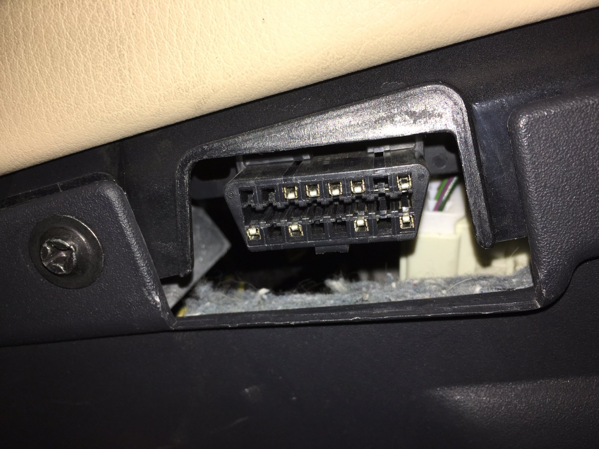

I did look at the OBD port and the connectors look okay but not sure.
And the below image is the dash lighting up - doors lock and unlock - turn signals going etc.
