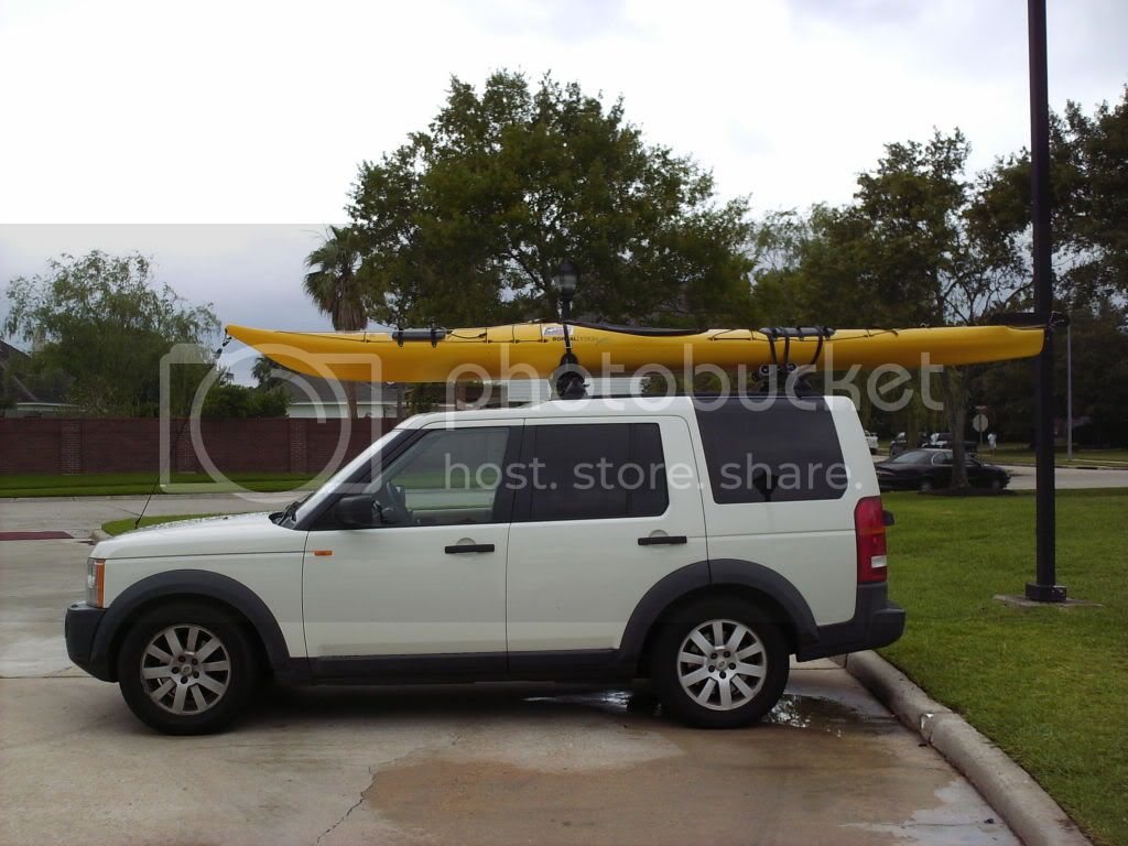

this is a 17'6" single.
I actually should have this slid back about another Ft.
the yak riacks I use have built in tie-downs, but state law requires the front to also be tied down, I do the back also ;)
I also have a 21' tandem, both of these are sea class touring kayaks.
