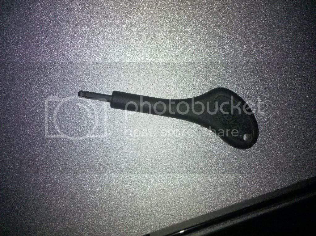

heres a pic
As you can see its just a standard allen wrench. If you have 4 holes in your radio you will need a u shaped tool. Bent metal close hanger will work, or you can buy the official tool on crutchfield.

heres a pic
