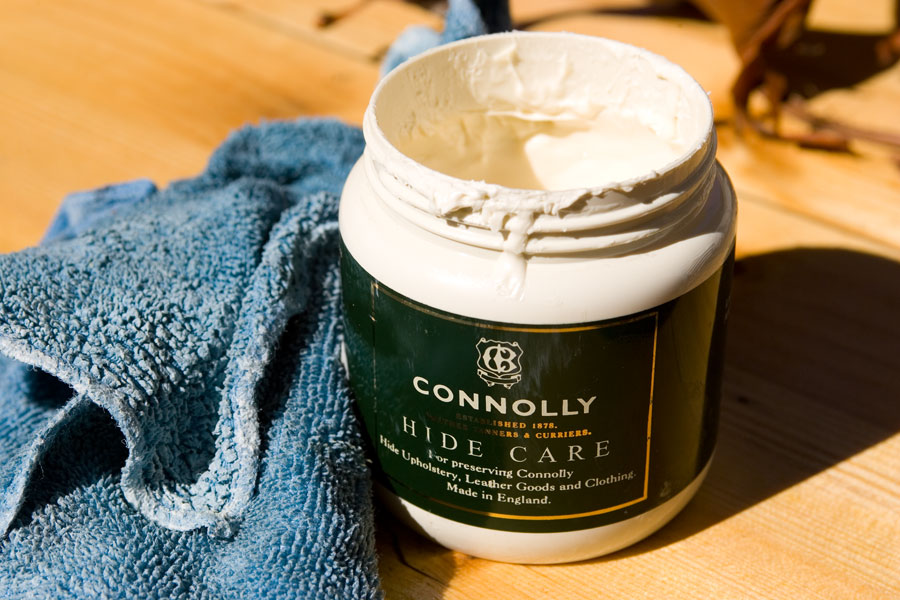

You should use Connolly hide food to keep your leather supple - it's specifically designed to keep your leather like new.
Available from Amazon.com, or from Horse saddle retailers.
http://www.amazon.com/Connolly-Leather-Limited-Hide-Care/dp/B0002LJQKW/ref=sr_1_1?ie=UTF8&s=automotive&qid=1237522796&sr=8-1
Eight quid gets you a jar of cream (not unlike a fancy face cream for SWMBO)
You might also want to consider the Connolly leather cleaner if your seats are well used, this cleans out all of the crud from the grain, before you move-on to the mositurising effects of the hide cream. Critical for long leather life.

The first problem you'll face, is that the cream tends to separate in the jar, leaving you something that looks like clotted cream that's gone off!
No problem - loosen the lid a little, and pop in the microwave for 30 secs on high - re-tighten the lid, and shake well.
You'll end up with a warm liquid that looks like a nice alfredo sauce or brandy sauce - creamy and smooth, and ready to apply.

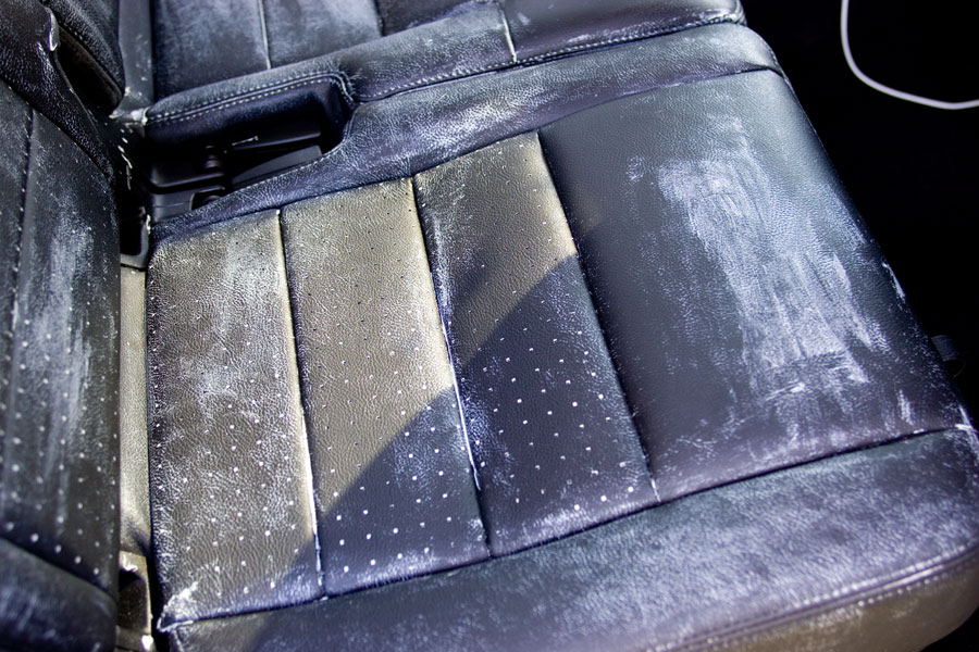

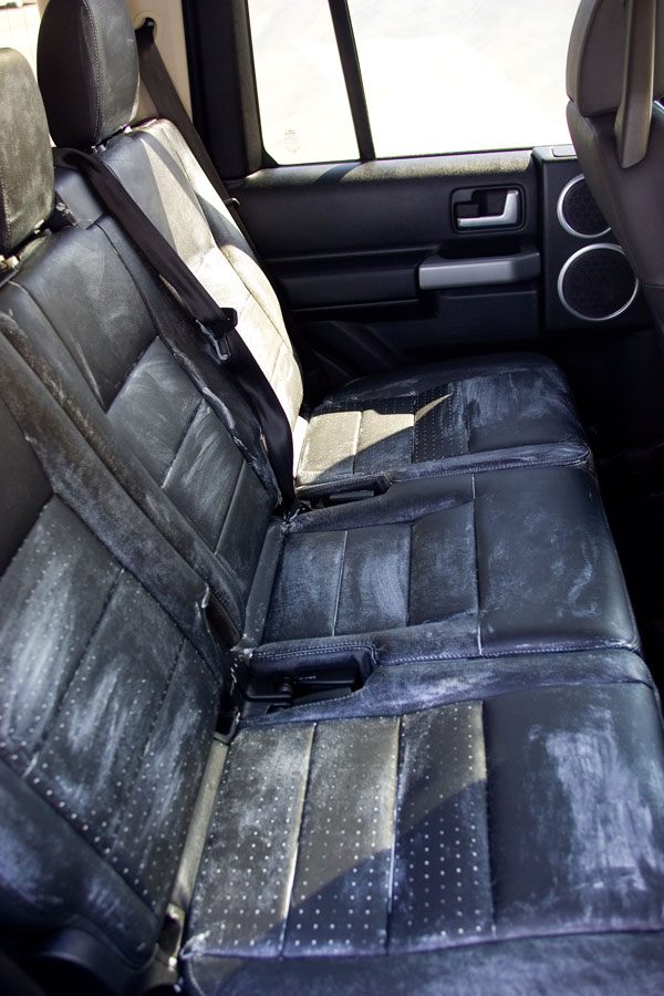

Next - put your Land Rover in full sun - and close all the doors and windows - we want the seats to get warm/hot as this aids the absorption of the cream.
Take a soft cloth, and apply the warm hide cream evenly all over the leather parts of the seats - it'll look like cr@p as it goes on, but don't worry!
If you get any on the plastic, or seat belts, or carpet, just wipe off with a soft cloth, no problems.
DON'T APPLY TO THE SUEDE-LIKE LEATHER - IT WILL PROBABLY STAIN!
When you have a good even coat over the seats - close the door and walk away for an hour - letting the sun do it's thing.

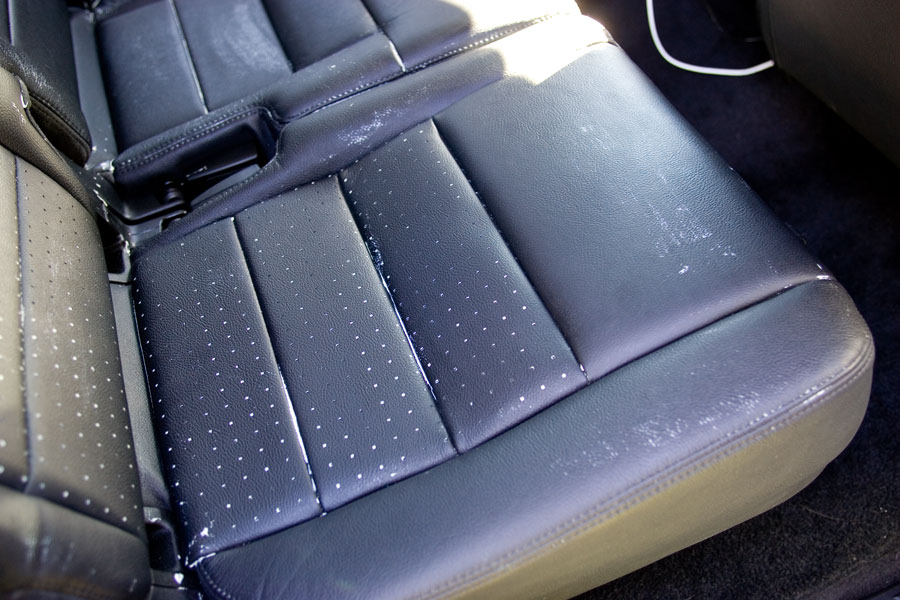

Go back to the LR after an hour in the sun, and you'll see the cream had really soaked in like this:

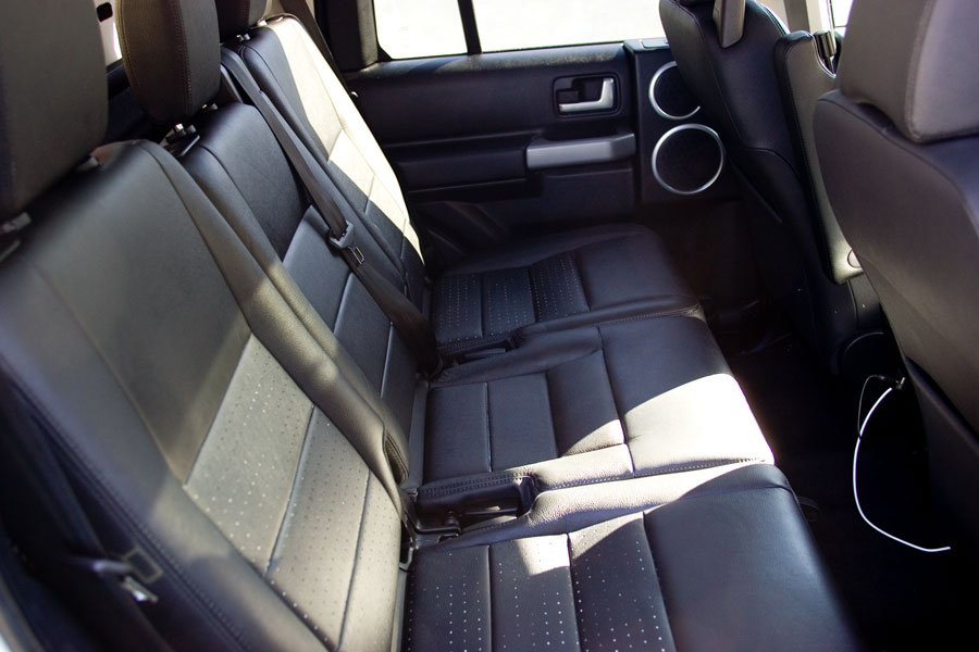

Take a new clean soft cloth, and buff the remaining cream until you have a nice, even, natural leather finish on the seats. Keep turning over the cloth so you get a new fresh side to buff with.
Re-seal the car, then go back with the cloth after another hour, just in case any more 'melted' cream is sitting on the leather surface. Don't worry about the cream in the seat perforations - it will vanish by itself overnight.
If you find the temperature drops on you, and you have hide cream going cold on the seats - get SWMBO's hair drier - set to medium, and gently warm the leather/cream before buffing - works the same as natural sunlight - just don't over-heat your leather by leaving it on one spot!
End result - your leather has been fed with lots of lanolin, and is now more supple, better protected, and likely to last a lot longer without splitting or cracking.
Repeat every 6 months or so to keep everything in great shape.
