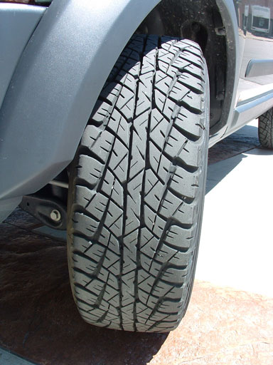

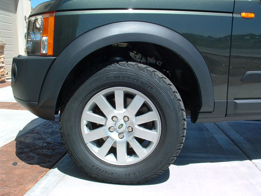

I thought you would like to see a post from another sight that gave me the idea of being able to put a 285/60/R18. (http://www.muddyoval.com/forum/viewtopic.php?t=1199&postdays=0&postorder=asc&start=0) This guy does an extensive review (I love land rover folk) of the Sumitomo HTR Sport A/T. Of course he says they dont rub or anything. It does give him a plus change in diameter of 1.5 inches. I am really thinking of getting the Terra Grapplers in this size...any comments or concerns???
Together we shall beet this lack of All Terrain rubber for this incredible vehicles (i have the se).
Thanks,
Nomad

Lets see that picture Mtnyeti...you are going to make LR3 history as the first documented Terra Grapler user. Make em detailed please ;D
Thanks a ton though,
Nomad
